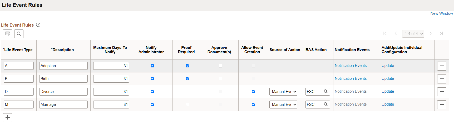

Use the Life Event Rules page (W3EB_LE_RULES) to set up life event rules that affect how data and information is processed for changes in marital status, birth, or adoption.
Navigation:
This example illustrates the fields and controls on the Life Event Rules page.
Field or Control |
Description |
Life Event Type |
Specify the life event type. Four different types of life events are available by default - Adoption, Birth, Divorce, and Marriage. You can modify existing life event types or define new life event types according to your organization’s needs. |
Maximum Days To Notify |
Specify the maximum number of days that can elapse between the date of the event and the date that the transaction is entered by the employee through the self-service transaction. Exceeding this time period does not prevent the employee from entering basic information, but a BAS Activity trigger will not be created even if Allow Event Creation is selected. If the employee enters the event after the maximum days allowed, the system displays a message on a self service page notifying the employee that his or her benefit elections cannot be changed. |
Notify Administrator |
Select to send an e-mail to the benefits administrator when this type of life event occurs informing him or her of the event. Additionally, if Proof Required is selected for an event, the administrator is automatically notified of the event regardless of the setting of Notify Administrator. |
Proof Required |
Select to indicate whether this type of life event requires proof before it is processed. If this field is selected, the HR database is not updated, BAS Activity and Cobra Activity triggers are not generated, and the administrator is notified of the event by e-mail. |
Approve Document(s) |
Select to enable the benefits administrator to approve, deny, or push back the uploaded life event documents. The employee can proceed to benefits enrollment only after the benefits administrator approves the document. |
Allow Event Creation |
This field is available if Benefits Administration is selected on the Installation table and Proof Required is not selected. A BAS Activity trigger is created only if the employee has at least one job managed by Benefits Administration as of the life event effective date. Selecting this field indicates that you want the system to trigger a BAS Activity for this type of life event and allows the employee to change benefit election through the eBenefit election pages. |
Source of Action |
This field is available and is required if Benefits Administration is selected on the Installation table and Allow Event Creation is selected. For a BAS Activity trigger to be created, you must enter Manual in the field. |
BAS Action |
This field is available and required if Benefits Administration is selected on the Installation table and Allow Event Creation is selected. Enter a BAS action code that is appropriate for this life event. Typically, this is FSC - Family Status Change. |
COBRA Action |
This field is available if both COBRA Administration andBenefits Administration are selected on the Installation table. This field is used only when the life event is for an employee managed by PeopleSoft Benefits Administration,Create Event is selected, and the resulting Benefits Administration event should create a COBRA Activity trigger when it finalizes. |
Notification Events |
Select to open the Notifications page and define the Notification ID for the life event. |
Add/Update Individual Configuration |

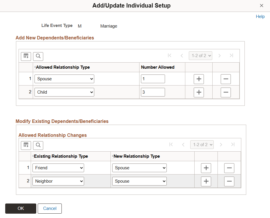

Select Update link to open the Add/Update Individual Config modal window and define the relationship types that can be added and updated as part of the selected life event type. |
This example illustrates the fields and controls on the Add/Update Individual Config modal window.
Field or Control |
Description |
Allowed Relationship Type |
Select the relationship type that will be available to the employee in the Add Individual/Beneficiary Information page when he adds a dependent or beneficiary as part of a life event. For example, if the Allowed Relationship Type is All Relationships, then the employee can add dependents with any relationship type. If there are two rows, one with Allowed Relationship Type as Spouse and second row with Allowed Relationship Type as Child, then the employee can add only relationships of type Spouse or Child. By default, All Relationships are selected. To know more on Individual/Beneficiary Information page, see Dependent/Beneficiary Info Page. |
Number Allowed |
Enter the number of dependents or beneficiaries the employee can add for the selected relationship type. |
Existing Relationship Type and New Relationship Type |
For each row you add, select the Existing Relationship Type and the New Relationship Type. This defines the relationships the employee can update and to which relationship it can be updated to. For example, if both Existing Relationship Type and New Relationship Type is set to All Relationships, then the employee can update his existing dependents or beneficiaries with any relationship type to any other relationship. If Existing Relationship Type is set to Friend and New Relationship Type is set to Spouse, then employee can only update relationships of type Friend and it can updated to only relationship type Spouse. By default, All Relationships are selected. |
