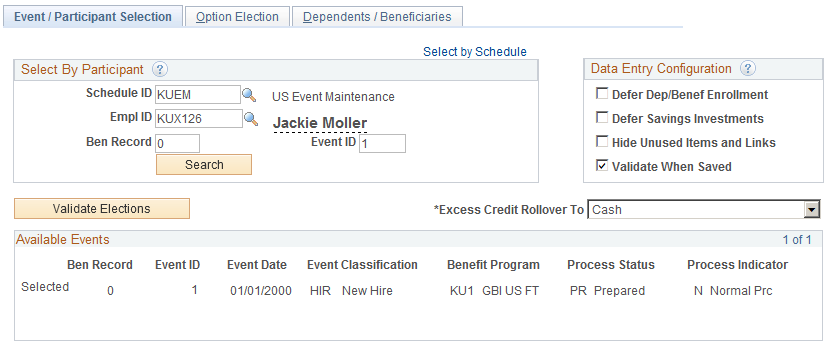

Use the Event/Participant Selection page (BAS_ELECT_EVENT) to select schedule or participant mode.
If a participant has multiple jobs, select the events in order to enter a participant's benefit elections.

This example illustrates the fields and controls on the Event/Participant Selection page. You can find definitions for the fields and controls later on this page.
Field or Control |
Description |
Select by Schedule |
Click to switch between Select By Participant mode and Select by Schedule mode. |
Ben Record (benefit record number) |
Used by the participant mode only. |
Event ID |
Search |
Click to locate event information for this participant. |
Defer Dep/Benef Enrollment (defer dependent/beneficiary enrollment) |
Select to defer dependent and beneficiary enrollment until after the entry of employee elections is complete. This hides the Dependent/Beneficiary grid for each plan on the Option Election page to streamline data entry. Dependent and beneficiary enrollment would be performed from the Dependents/Beneficiaries page instead. |
Defer Savings Investments |
Select to defer savings investment enrollment until after the entry of employee elections is complete. This hides the Investment Allocation grid for each savings plan on the Option Election page to streamline data entry. Investment allocation would be performed from the Dependents/Beneficiaries page instead. |
Hide Unused Items/Links |
Select to streamline data entry by not displaying certain fields and navigation links if they are not applicable to a plan or option. This reduces the need to press Tab to move over unused fields, but it may break the data entry rhythm by varying the number of fields per plan. |
Validate When Saved |
Select to have data entry validated automatically when you save the record. When this check box is deselected, data entry is validated only on demand, when you click the Validate Elections button. |
Excess Credit Rollover To |
Overrides the default destination of excess benefit credits for the participant. |
Validate Elections |
Validates all plans and options for correct and sufficient entry. These are the same validations that are automatically performed when the page is saved if that feature is selected. All discrepancies are presented as warnings only, so the employee's elections can always be successfully saved for later correction. |
Available Events
This group box displays the event associated with the selected schedule ID and employee ID after it's accessed by the system. For multiple jobs, more than one event might be found. Select the event on which you want to perform data entry.

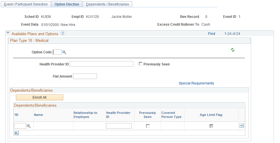

Use the Option Election page (BAS_ELECT_ENROLL2) to enter benefit elections.
Navigation:
This example illustrates the fields and controls on the Option Election page. You can find definitions for the fields and controls later on this page.
Field or Control |
Description |
Option Code |
Select or update the benefit plan option currently assigned to the participant. |
Special Requirements |
Click to view the option's special requirements:
Enroll All |
Click to enroll all available dependents or beneficiaries in a particular plan type. The system looks at the list of dependents and beneficiaries currently associated with the participant and validates enrollment eligibility against two things:
The system inserts the new dependent and beneficiary rows for each plan type and overwrites all dependent and beneficiary records currently assigned to the benefit plan type in question. |

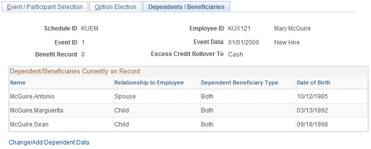

Use the Dependents/Beneficiaries page (BAS_ELECT_DEPBENEF) to enroll dependents and assign beneficiaries.
Navigation:
This example illustrates the fields and controls on the Dependents/Beneficiaries page. You can find definitions for the fields and controls later on this page.
Dependent/Beneficiaries Currently on Record
This group box summarizes, for review only, all of the dependents and beneficiaries currently associated with the participant.
Change/Add Dependent Data
Click the Change/Add Dependent Data link to open the Update Dependent/Beneficiary (DEPEND_BENEF) component. The participant's current dependents can be edited, or new individuals added when you have correction authorization to the Update Dependent/Beneficiary component.
Note: When you are adding new dependents because of a life event such as birth or marriage, the effective date for the new dependents should be the same as the Benefits Administration event date.
Elections Requiring Supplemental Information
Displays links to all plan types requiring additional dependent, beneficiary, or savings investment information to complete the employee's election choices. This information can also be entered from the Option Election page, but is repeated here to provide an alternate method of data entry.

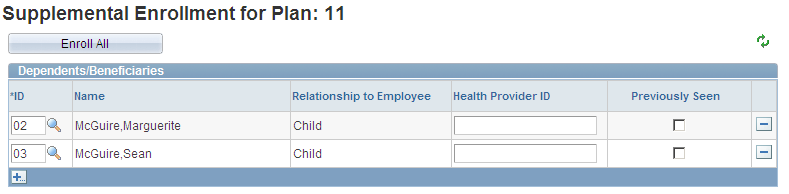

Use the Supplemental Enrollment page (BAS_ELECT_DEPBENWK) to enter dependent or beneficiary data.
Navigation:
Click Enroll Dependents or Assign Beneficiaries on the Dependents/Beneficiaries page.
This example illustrates the fields and controls on the Supplemental Enrollment page. You can find definitions for the fields and controls later on this page.
The information displayed on this page depends on the plan type being accessed. This page presents essentially the same field layout as found on the Option Election page for enrolling dependents, assigning beneficiaries, and allocating savings investments.
