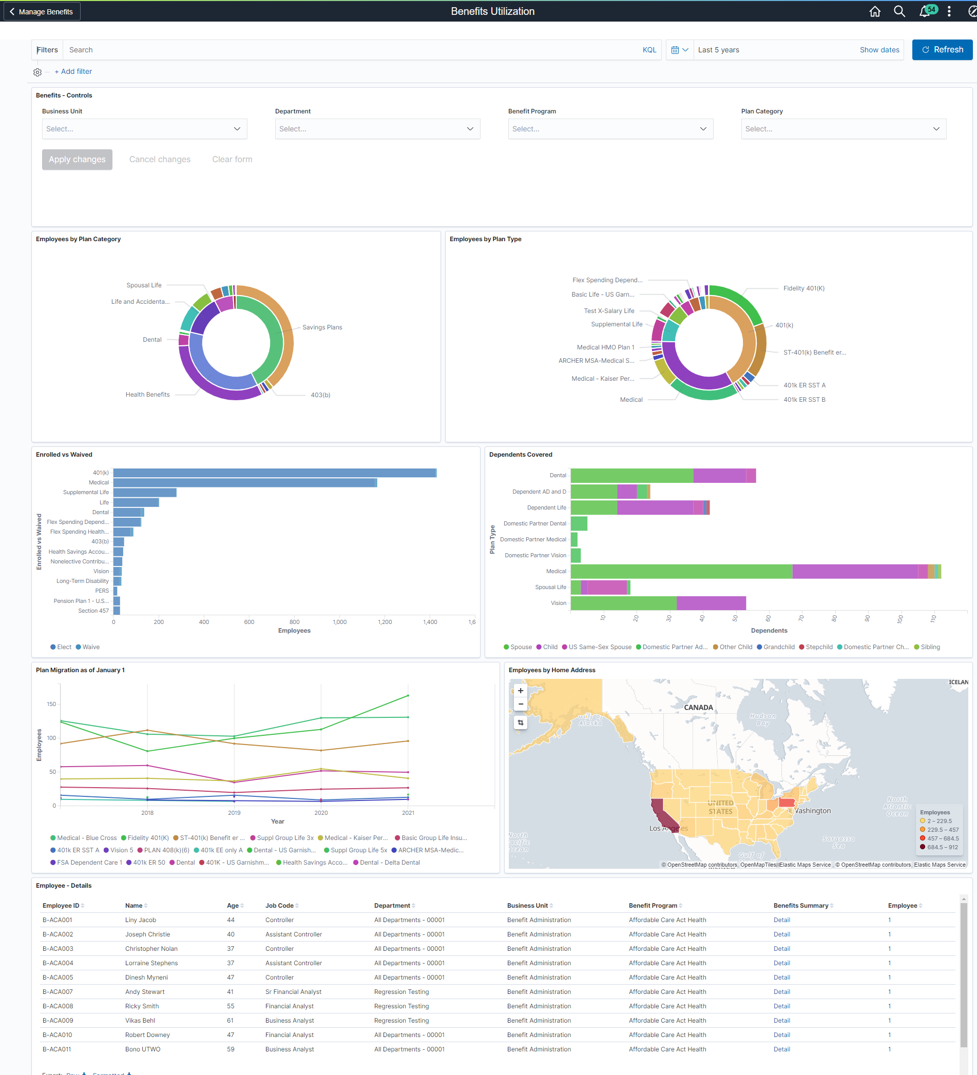

Use the Benefits Utilization Dashboard (HC_HBN_PLAN_UTILIZATION_FL) to review and analyze the Insights visualizations related to benefits data. Based on the user privileges, the administrators can access the dashboard.
Navigation:
Click the Benefits Utilization Tile.
This example illustrates the Benefits Utilization Dashboard.
Warning! PeopleSoft Insights dashboards may not render properly if you access them using unsupported platforms.
The Benefits Utilization dashboard provides you with different visualizations to analyze benefits data. When you select filters or chart items, Insights dynamically updates all visualizations using the sources from the index.
Each visualization enables you to inspect the chart, table or map to view the details of that visualization. Pause over a visualization to have the have additional page elements appear, view numbers, or click items to add filters to your visualizations.

Benefits – Controls
Additional Filters allow you to filter the analytics based on:
Business Unit
Department
Benefit Program
Plan Category
Delivered Benefits Utilization Visualizations
The Benefits Utilization Dashboard provides this collection of visualizations:
Visualization |
Description |
Employees by Plan Category |
This visualization shows the benefit plan categories and corresponding plan types based on the employees who opted for it. You can hover over the visualization to see the count and percentage of employees for each benefits plan category and plan type. By default, the inner doughnut shows the top five benefits categories with the highest number of employees. The outer doughnut represents the top ten benefit plan types for each category. You can click on each category or plan type to filter the visualizations. For example, if we click on Savings Plan, the page refreshes, and all the charts are updated to show data based only on the selected category. Note: You can modify the number of items to be displayed in the visualization based on your organization's requirements. |
Employee by Plan Type |
This double doughnut visualization shows the count and percentage of employees based on their selected plan type. The inner doughnut represents the benefits plan type. The outer doughnut represents the benefit plans corresponding to the plan type. You can hover over the image and view the count and percentage of employees who opted for a specific plan type, or benefits plan. Click on a plan type or a specific benefits plan to filter the visualizations accordingly. |
Enrolled vs Waived |
This visualization shows how many employees are currently enrolled or have currently waived a specific plan. Employees with terminated benefits and employees that have never been enrolled are not included in this count. You can hover over the image and view the count of employees enrolled or waived for a specific plan type. Click on the chart to filter the analytics based on a specific plan type. |
Dependents Covered |
This visualization shows the current number and type of dependents enrolled for each plan type. You can hover over the image and view the type and count of dependants for each plan type. Click on the chart to filter the analytics based on a specific plan type or dependant type. |
Plan Migration as of January 1 |
This visualization shows how many employees have enrolled for a specific plan each year (as of January 1). By default, the dashboard shows the last five years of data. Note: To create the January 1st data, a derived value is created in the index. The index looks at the enrollment date to determine if the employee had the benefit plan on Jan 1st of that year. If so, a value is placed in the index for that year. The index is based on a rolling five years period. To use a different date than Jan 1st, you can modify the index's derived value calculation. You can hover over the image and view the count of employees for each plan type based on the year. Click on the chart to filter the analytics based on a specific plan type or year. |
Benefits – by State |
This visualization shows the geographical distribution of the employees on an interactive map. The State provided in the employee's home address is used to populate the visualization. You can hover over the image and view the number of employees residing in each state. Click on the chart to filter the analytics based on a specific state. |
Employee Details |
Based on the applied filter, the Employee Details section lists out all the employees and their details in tabular form. Click see the Detail link against an Employee ID in the Benefits Summary column to open the Benefits Summary page. For more information, see Benefits Summary Page. |
