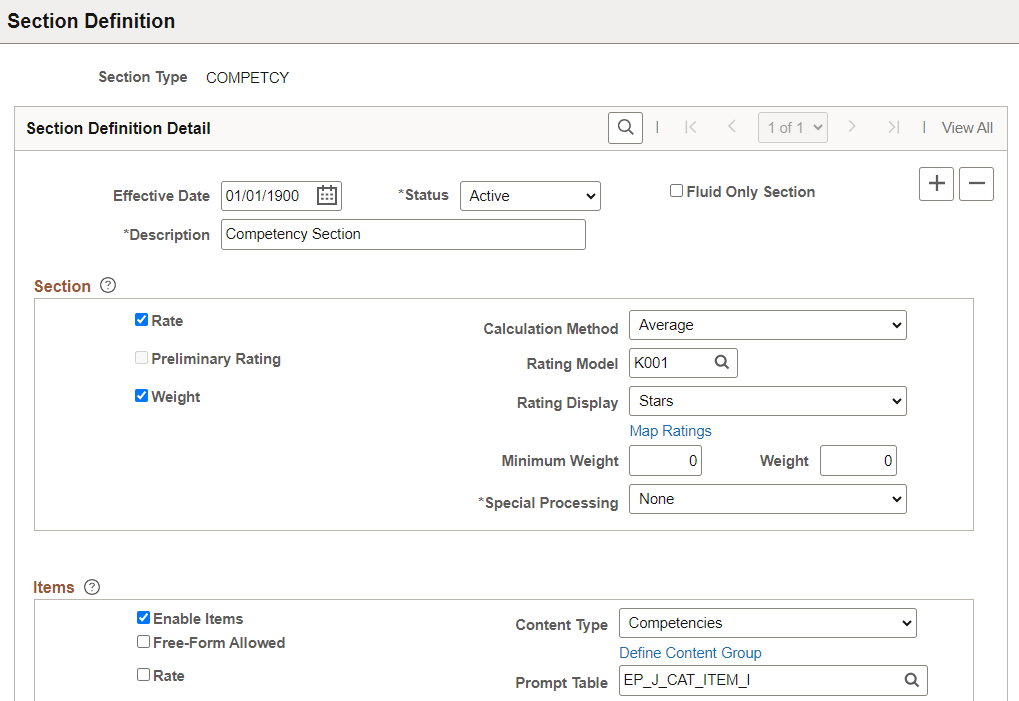

Use the Section Definition page (EP_SECTION_DEFN) to define sections.
Navigation:
This example illustrates the fields and controls on the Section Definition page (1 of 2).
This example illustrates the fields and controls on the Section Definition page (2 of 2).
Enter the information that you want to use later to populate the fields on the Template Definition - Structure page for the specified section. The descriptions you enter here are used to identify the sections that you want to add on the Template Definition page.
Field or Control |
Description |
Fluid Only Section |
Select this check box if the corresponding section is applicable only to documents in Fluid. For example, the Recognition Summary section is a Fluid-only section. |
Section
Field or Control |
Description |
Rate |
Select this check box to enable a rating assignment for the section, either by a system calculation or manually. A rating field or display appears in the section summary of each document created based on a template that includes this section. When the Rate check box is selected, a section summary rating must be specified (either by a system calculation or manually) in order to submit documents for approval. The system enables this check box if Business Objectives, Learning, None, or Overall Summary is selected in the Special Processing field. |
Calculation Method |
Select the calculation method used for the section. Values include:
The system enables this field if the Rate check box is selected and the Special Processing field is set to Business Objectives, Learning, None, or Overall Section. |
Preliminary Rating |
Select this check box to enable the manager to enter a preliminary rating for the performance document. The system enables this check box if the Rate check box is selected and the Special Processing field is set to Overall Summary. |
Rating Model |
Select the default rating model for the section. The system enables this field if the Rate check box is selected and the Special Processing field is set to Business Objectives, Learning, None, or Overall Summary. |
Rating Display |
Select how values of the selected rating model are displayed on documents. This field becomes editable after selecting a rating model. Values are: Drop-Down Box Note: Always use the Drop-Down Box option if the selected rating model has more than 5 rating values. Radio Buttons Note: Do not use the Radio Buttons option for Fluid ePerformance. If selected, the system treats the value as Drop-Down Box. (Fluid ePerformance only) Stars. This rating display supports rating models with 5 or less values. |
Order By |
Select how rating values are ordered using the setup data of the selected rating model. This field appears if the selected rating display is Drop-Down Box. Note: This option is Fluid ePerformance only. Values are: Numeric Rating (Numeric Rating column in rating model setup) Rating Description (Description column in rating model setup; default value) Review Rating (Rating column in rating model setup) Rating models are defined on the Rating Model Page. |
Map Ratings |
Select to assign a star rating value (1 Star through 5 Stars to each review rating value of the selected rating model on the Map Ratings page (EP_MAP_RATING_TBL). This link appears if the selected rating display is Stars. Note: This option is Fluid ePerformance only. You must complete this mapping to use the star rating display. |
Weight (check box) |
Select this check box to enable the section to have a weighting relative to the other sections in the document. The system enables this check box if the Rate check box is selected and the Special Processing field is set to Business Objectives, Learning, or None. You cannot weigh sections of a performance document when you select a calculation method of Summation or Review Band for the Overall Summary section and elect to have the system calculate performance ratings. (You enter calculation instructions through the Template Definition component.) When selected, the Section Weight field appears in the section summary of documents created from templates that include this section. The field name is changed to Summary Weight when the document is in the Evaluation in Progress status. |
Minimum Weight |
Enter the minimum weight for the section. This field is used when ratings are calculated to ensure that the section weight cannot fall below a minimum value. The system enables this check box if the Weight check box is selected. |
Weight (field) |
Enter the default weight for the section. The system enables this check box if the Weight check box is selected. |
Special Processing |
This field determines the type of information that is entered in this section and how the system processes the information.
Items
Fields that are displayed in this group box determine if the section on the document can contain content items such as mission statements, initiatives, goals or objectives, competencies, responsibilities, or free-form items. A section must contain all items of the same content type. Items are evaluated or tracked depending on the rules that you specify.
The Items group box (the Enable Items check box specifically) becomes editable if the Special Processing field is set to Business Objectives or None.

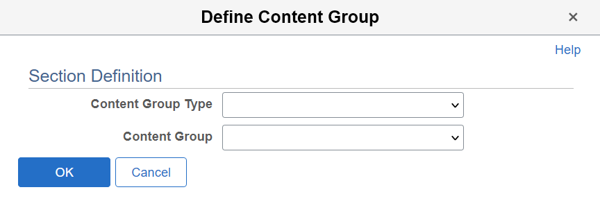

Define Content Group |
Click this link to access the Define Content Group page (EP_CONTENT_SEC) where you can select both a content group type and a content group. Selecting a content group type and content group determine what sections will appear on the Template Definition page. This information is set up in the content catalog. |

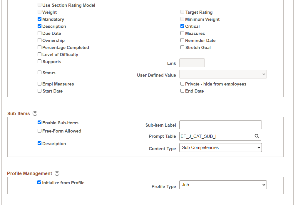

Sub-Items
The system enables fields in this group if the Enable Items check box in the Items group box is selected.
Field or Control |
Description |
Enable Sub-Items |
Select this check box to indicate that the section can contain sub-items. Sub-items are typically sub-competencies that are created through the Competency section. |
Sub-Item Label |
Specify the label used to name sub-items in this section, if
applicable. If not specified, the default label for sub-items is Sub-Item.
Note: This field applies to Fluid ePerformance only. It becomes editable when the Enable Sub-Items field is selected. |
Free-Form Allowed |
Select this check box to enable users to add free-form (non-coded) sub-items to this section. |
Prompt Table |
Select the name of the table that holds the sub-items that are included in the section. |
Content Type |
Select the content type from which content items will be selected. The content types available for selection are those that are associated with the value you selected in the Content Type field in the Items section. Content types are set up under a content group type in the content catalog. The Content Type and Content Group Type fields are used for search when adding a predefined competency to the evaluation criteria specified on the document template. |
Description |
Select this check box to have the description for the sub-item appear on the evaluation. During the evaluation process, managers can click an update link on the evaluation to edit the description for the sub-item. |
Profile Management
Use this group box to enable the system to automatically populate relevant content items in the section when new documents are created for employees.
Field or Control |
Description |
Initialize from Profile |
Select this check box if you want relevant competencies or responsibilities that are associated with a specified profile type (through profiles) to be automatically loaded from a profile into documents that are created for employees. This check box becomes editable if the Enable Items check box in the Items group box is selected and a content type is specified in the system. |
Profile Type |
Select the profile type to be used to identify the profiles of the content items to be populated. These profile types are defined in the Manage Profiles business process. The system enables this field if you select the Initialize from Profile check box. A role can be tied to person profile in the Evaluation Role Rules grid. |

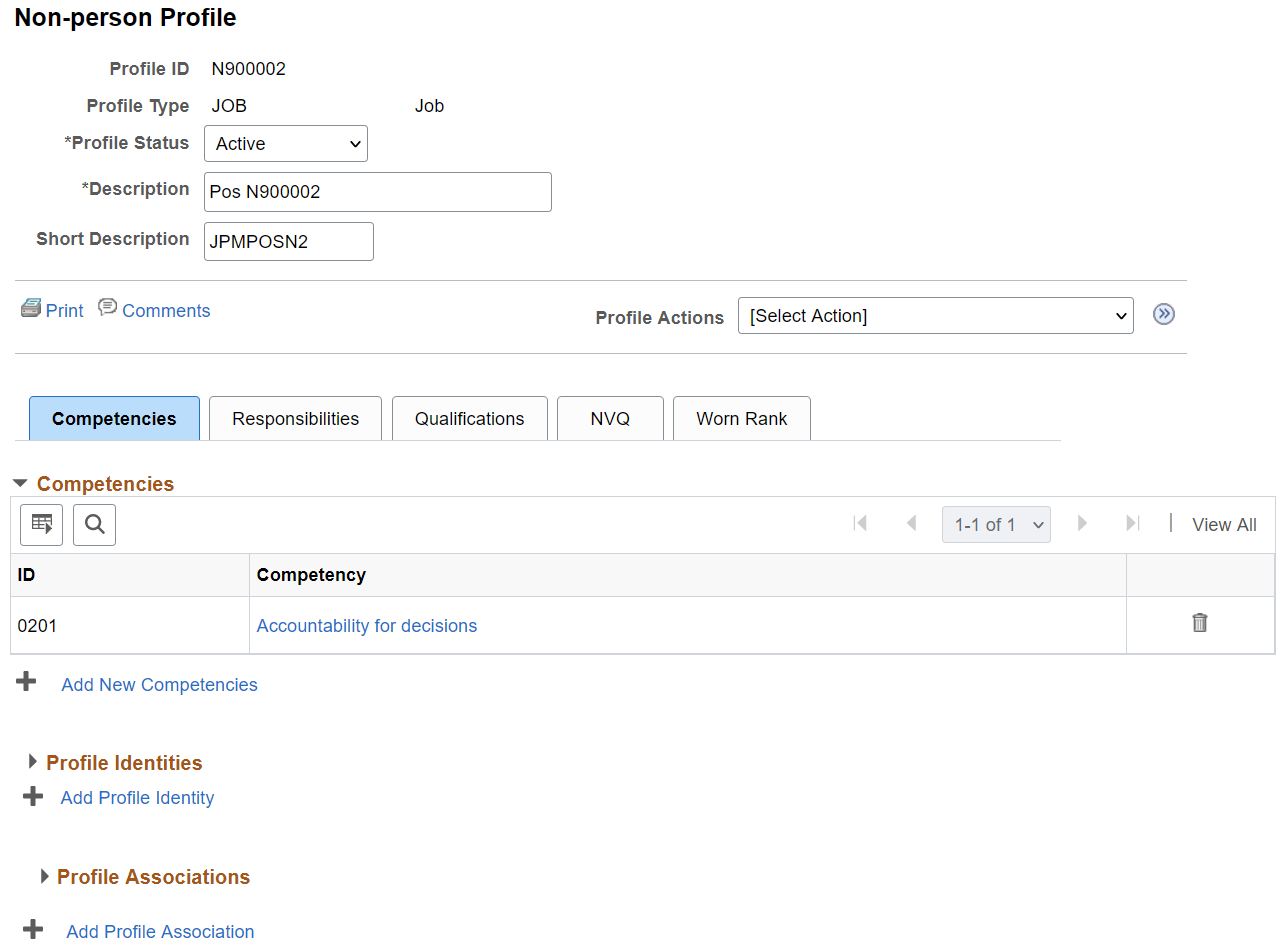

Here is an example of how the system determines which content items to populate to a performance document for an employee in the document creation process.
Suppose that the Initialize from Profile option is enabled for the Competencies section and you have specified Job as the profile type. At runtime, when a user creates a performance document using a template that includes the Competencies section, the system:
Identifies the profile type (Job) that is specified in the Profile Type field for the section, and locate all profile identity options that are associated with that profile type.

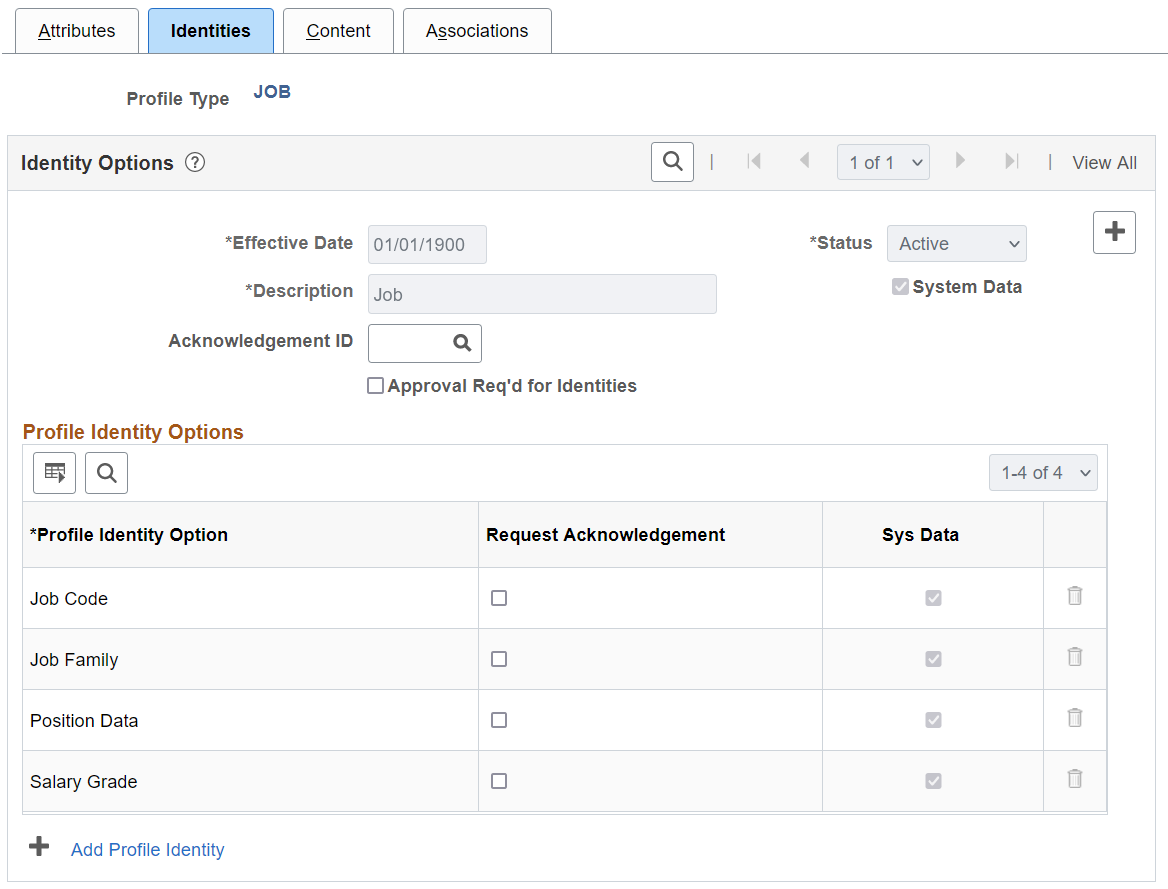

This example illustrates the fields and controls on the Profile Types - Identities page.
Identifies, for each profile identity option, key values that are specified for all of the profiles.
This example illustrates the fields and controls on the Non-person Profile page.
Orders these profile identity options according to the order sequence that is specified on the Profile Identity Options Page.
For example, 20 - POSITION, 30 - JOB_CODE, 40 - JOB_FAMILY, and so on.
Retrieves the job information record of the document’s employee.
With that, the system takes the first profile identity option (for example, 20 - POSITION) and sees if there is a match between the employee’s job record and any of the profiles identified.
If there is a match (which means that the employee’s position data is present and it matches a key value of an identified profile that has the POSITION profile identity option, the system loads the content items (competencies or responsibilities, based on the specified content type in the section definition) in the section of the document to be created.
If no match is found, the system takes the second profile identify option (for example, 30 - JOB_CODE) and looks for a match.
If the system goes through all the profile identity options of the profiles and is unable to find a match, it stops and no content items will be loaded to the document.
As soon as the system identifies one profile from which it can load content items, it stops the process and does not look for any other profile to load additional content items.
Use the Define Content Group page (EP_CONTENT_SEC) to select both a content group type and a content group.
Navigation:
Click the Define Content Group link on the Section Definition page.
This example illustrates the fields and controls on the Define Content Group page.
Select the content group type and content group. The content group type and content group determine what sections will appear on the Template Definition page. This information is set up in the content catalog.
