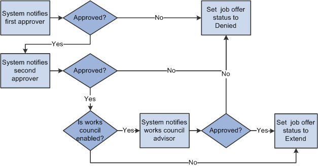

Oracle delivers a default approval process for job offers. This process includes up to three approvers:
The first approver is the primary hiring manager's supervisor.
To identify the supervisor of the hiring manager, the system uses the Target Information page.
If the job offer is not associated with a job opening, you can specify a hiring manager on the Prepare Job Offer page when you create the job offer. If there is no hiring manager, then the first approval step is skipped. If the primary hiring manager's supervisor is inactive, the first approver is the supervisor of the inactive employee.
The second approver is the recruiter or recruiters for the job opening or, if the offer is not associated with a job opening, the recruiter specified on the offer.
When multiple recruiters are specified for a job opening, any one of the recruiters can approve the job offer.
If there is no recruiter on the job opening (or on the offer, for an offer without a job opening), the system routes the approval request to the recruiting solutions approval administrator.
If works council approvals are activated, and if the job opening is associated with a works council ID, then the works council spokesperson is the third and final approver.
The works council spokesperson is specified in the Spokesperson field on the Works Council Table page.
See Setting Up Works Councils.
If there isn't a works council ID tied to the job offer, or if there is no one entered in theSpokesperson field, the system skips this approval step.
The following diagram illustrates the delivered approval process, which includes three approvers when works council approval is needed and two approvers otherwise. The process starts when the system sends the first approver a notification at the time the offer is submitted. As each approver approves the offer, the system sends notifications to the next approver.

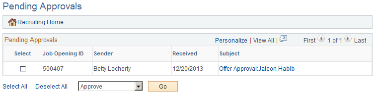

Use the Pending Approvals page (HRS_RECRUIT_CONSOL) to view and act on pending approval requests.
Navigation:
This example illustrates the Pending Approvals page.
Pending Approvals
Field or Control |
Description |
Select |
To approve or deny multiple pending approvals, select the check boxes for the transactions that you want to approve or deny, If offer approval processing has been turned off in the Recruiting Installation component, the check box for the transaction is disabled and the user cannot act on the pending approval. |
Job Opening ID |
Displays the job opening ID for the transaction to be approved. |
Sender |
Displays the name of the person who submitted the offer for approval. |
Received |
Displays the date that you received the request to approve this job offer. |
Subject |
Job offer approvals start with the text Offer Approval. Click a job offer approval link to access the Prepare Job Offer page, where you can view details and approve or deny the offer. If offer approval processing has been turned off in the Recruiting Installation component, the link is disabled and the user cannot access the transaction from this page. |
<Action> |
To approve or deny transactions from the Pending Approvals page, first select the transactions, then select Approve or Deny from the drop-down list box below the Pending Approvals grid, then click Go. The system approves or denies the selected transactions and removes them from the page. |

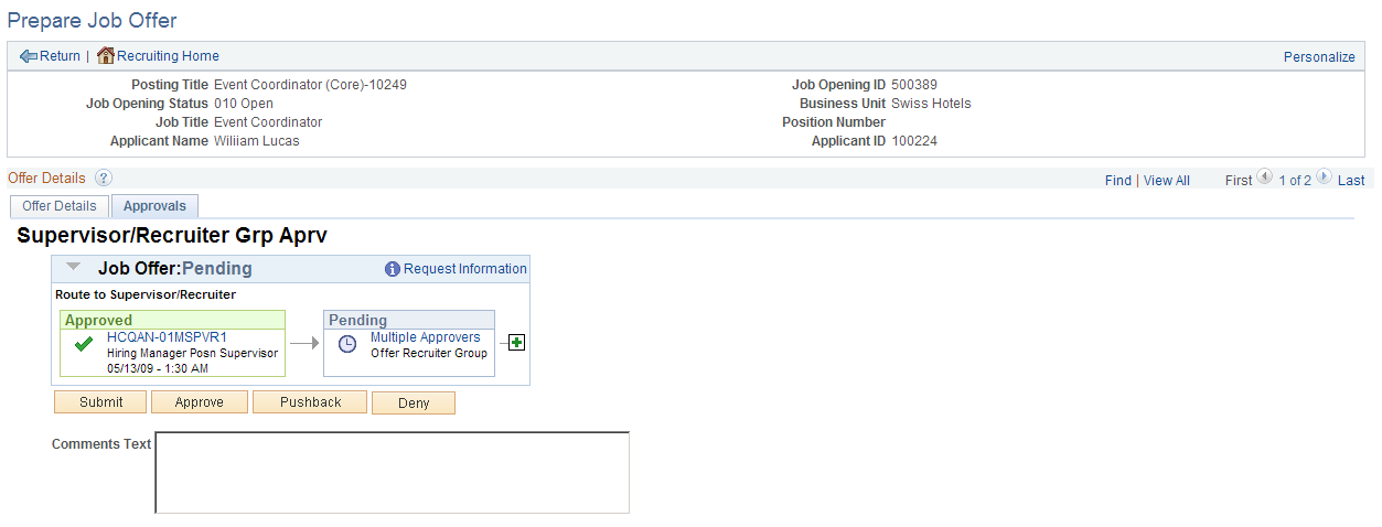

Use the Prepare Job Offer Page: Approvals tab (HRS_APP_RCMNT) to approve, deny, or push back a job offer.
This tab is visible after a job has been submitted for approval. However, if approval processing is subsequently turned off in the Recruiting Installation component, this tab is no longer visible.
Navigation:
Click the link for a job offer transaction on the Pending Approvals page, then access the Approvals tab.
This example illustrates the Approvals tab on the Prepare Job Offer Page.
This example illustrates the fields and controls that a recruitment administrator sees on the Prepare Job Offer page: Approvals tab
Note: The Approvals tab appears on the Prepare Job Offer page only after the offer is submitted for approval.
Job Offer: <Approval Status>
This group box displays a graphical representation of the approval process. There is a box for each approver. The box title shows the approver's status, while the box contents include the approver's name, the approver's role in the approval process (for example, the hiring manager's supervisor), and the date, if any, when the approver took action on the approval request.
Additional graphical elements in this group box include color-coding the approver boxes according to the approver's status, and status icons next to the approver's user ID.

Approval Controls for Assigned Approvers
The following buttons are visible only to the current approver.
Field or Control |
Description |
Approve |
Click to approve the job offer. When final approval is reached, the system changes the job offer status from Pending Approval to Extend. |
Pushback |
This is available only to approvers other than the first approver. Click to send a notification to the previous approver telling them the job offer needs to be changed. |
Deny |
Click to reject the job offer and set the job offer status to Denied. |

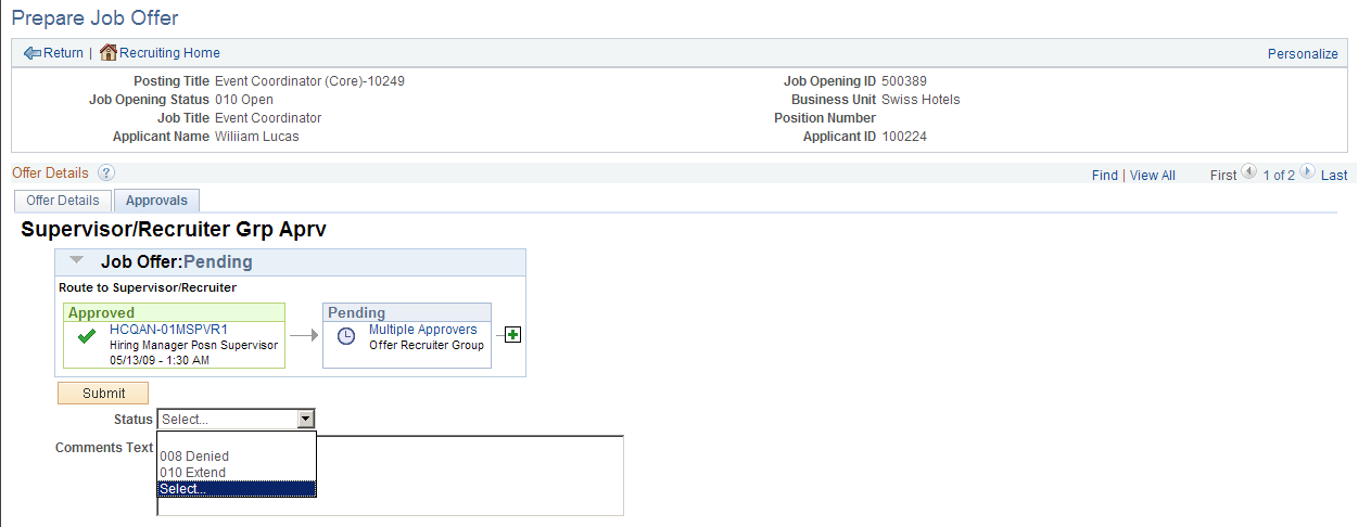

Approval Control for Administrators
Field or Control |
Description |
Status |
When an administrator views the approval chain, the buttons that the assigned approvers use are not visible. Instead, there is a Status drop-down list box that the approver can use to override the approval process. The administrator can select either Extend or Denied. The override takes effect when the administrator submits the job offer. After an administrator overrides the approval process, the approval process status is Terminated, regardless of whether the administrator approved or denied the job opening. |

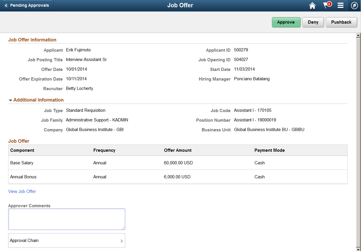

Use the fluid Job Offer approval page (EOAWMA_TXNHDTL_FL) to approve a job offer.
Navigation:
On the Manager Self-Service home page, click the Approvals tile to access the Pending Approvals page. Then click a job offer entry on the Pending Approvals page.
This example illustrates the fluid Job Offer approval page.
Approval Options
The approval options on this page are common to all fluid approval transactions, as described in the documentation for the Pending Approvals - <Transaction Details> Page.
Field or Control |
Description |
Approve,Deny, and Pushback |
Use these buttons to take action on the requested approval. |
Approver Comments |
Enter any comments related to the approval action you take. |
Approval Chain |
Click this item to open the Approval Chain page, where you can review information about all approvers for the transaction. |
Job Offer Details
The job offer fields on this page provides information about the transaction you are being asked to approve. Fields correspond to the same-named fields on the Prepare Job Offer Page
Field or Control |
Description |
View Job Offer |
Click this link to access the Prepare Job Offer page, where you can review complete offer information. |
