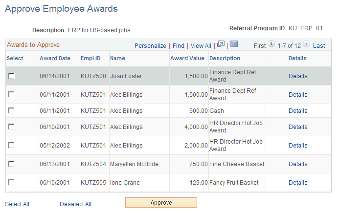

Use the Approve Employee Awards page (HRS_MASS_APRV) to approve referral awards that have the status of Needs Approval.
Navigation:
This example illustrates the Approve Employee Awards page.
All awards that have the Needs Approval payment status appear on this page.
Field or Control |
Description |
Select |
Select the referral awards that you want to approve. |
Details |
Click to access the Referral Award Details page, where you can view referral award details. |
Select All |
Click to select all referral awards in the list, including those outside the view area. |
Approve |
Click to approve the selected referral awards. After awards are approved, they do not appear on this page again. |
