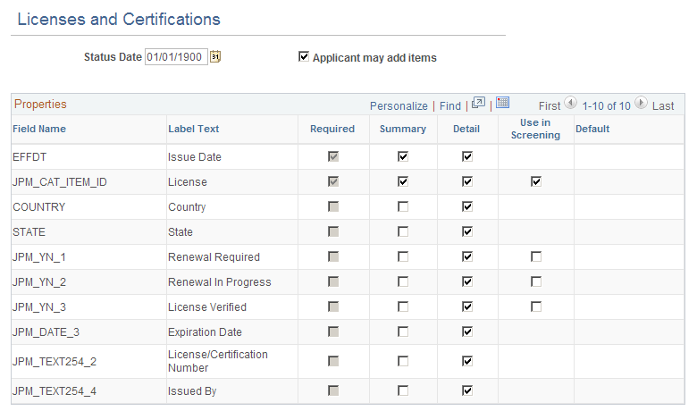

Use the Content Section Configuration – <Content Type> page (HRS_JPM_SECT_CFG) to configure profile content types for use in Talent Acquisition Manager.
The search dialog for this page enables you to access content types from the primary person profile type. You cannot add additional content types using this page.
Note: The page title changes according to the content type that you are configuring.

This example illustrates the Content Section Configuration – <Content Type> Page .

This grid lists all the properties (fields) for the content type. Content type properties are defined using the Manage Profiles module in PeopleSoft Human Resources.
Field or Control |
Description |
Field Name and Label Text |
These fields identify a specific field that is part of the content type definition. For example, the content type Competencies, which you use for applicant competency ratings, includes fields such as Rating Model and Proficiency. |
Required |
If this check box is selected, the property is required. Otherwise, it is optional. For example, in the Degrees content type, the degree itself is a required property, while additional properties such as the school code are optional. This check box is read-only; this setting comes from the content type definition in the Manage Profiles module. |
Summary and Details |
Select the Summary check box to include the property as a column in the grid that represents this content type. Select the Details check box to include the property on the detail page for this content type. This check box is not available when the Applicant may add items check box is deselected. These settings affects the grids and detail pages on the Job Opening page and on the job application in Candidate Gateway. They do not affect the grids on the Application Data page in Talent Acquisition Manager. Note: The best practice is to limit the number of fields that are marked as summary fields. Too many summary fields results in excessively wide grids. This is a usability issue for all users, but particularly for Candidate Gateway applicants, who are untrained casual users. |
Field or Control |
Description |
Use In Screening |
Select this check box to make the field available for screening. Fields where this check box is selected are included in the criteria list on the Job Opening - Screening Criteria page, where you choose which of the available criteria to use in a specific screening level. Each selected item is treated as a separate screening item, and users must set up screening scoring bearing in mind the interrelationships between items. For example, the delivered configuration for the Competencies content type has only one field that is available for screening: the proficiency field. When you add a competency to a job opening, you will enter data such as the competency name, rating type, and the rating. But when you configure the screening criteria for the job opening, the rating is the only competency-related information that is listed in the grid where you select screening criteria. (Because the rating is associated with a particular competency, rating model, and evaluation type, the screening process automatically looks for a rating for the associated competency, rating model, and evaluation type). If you were to change the configuration for competencies so that the competency name was the only field used in screening, then the screening process would simply check that the applicant's application lists the competency, regardless of the applicant's rating. Only certain fields are available for selection, including the content item ID (JPM_CAT_ITEM_ID for regular content types and JPM_ADHOC_DESCR for ad hoc content types), rating-related fields (JPM_RATING1 through JPM_RATING3), and yes/no indicators (JPM_YN_1 through JPM_YN_5). |
Default |
Displays the default value for the property. |
