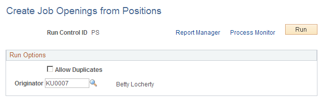

Use the Create Job Openings from Positions page (HRS_RUN_CR_JOB) to create job openings from open positions.
Navigation:
This example illustrates the Create Job Openings from Positions page.

Allow Duplicates  |
 Select to have the system create job openings for all position openings, regardless of whether a job opening already exists for a position. Deselect this option if you do not want the system to create duplicate job openings. By default, this option is deselected.  |
Originator  |
 Select the ID of the person that you want to be the originator of the new job openings. The originator appears in the Created By field on the Job Opening page, and will have access to the job openings after the system creates them. By default, the system populates this field with the current user's ID.  |
Run  |
 Click to access the Process Scheduler Request page, where you initiate the process.  |
