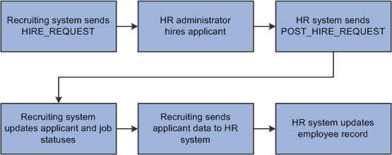

Hire Processing
When you submit the hire request, the system sets the applicant’s disposition to Ready to Hire and triggers the HIRE_REQUEST message, which causes the applicant's name to appear on the Manage Hires Page. The system also sends notifications based on settings on the Hire Notifications Page. This page has separate settings for hire notifications and error notifications.
The Manage Hires page lists pending hire transactions and provides links that the human resources administrator uses to process the hire. The hire process is complete when the human resources administrator has set up both personal data and job data for the applicant.
When the applicant is hired, the HR system sends the POST_HIRE_REQUEST message to the recruiting system. The recruiting system then does the following:
Updates the applicant record with the employee ID.
Changes the applicant's disposition to Hired.
This can trigger additional status changes as well, depending on how status change effects are configured. For example, the delivered status change effects update the applicant's other job applications to a Rejected disposition. Status changes can also trigger notifications based on your status configuration.
Decreases the Available Openings count for the job opening by one and changes the job opening status to Closed if no more openings are available.
Copies applicant data to the newly hired employee’s records in PeopleSoft Human Resources.
Profile-related data is copied into profile management records. Other data is copied into workforce administration records.
The specific data elements that are transferred depend on settings that you configure on the Manage Hire Setup Page.

This diagram illustrates the integration between Recruiting Solutions and Human Resources Administer Workforce during the hiring process.

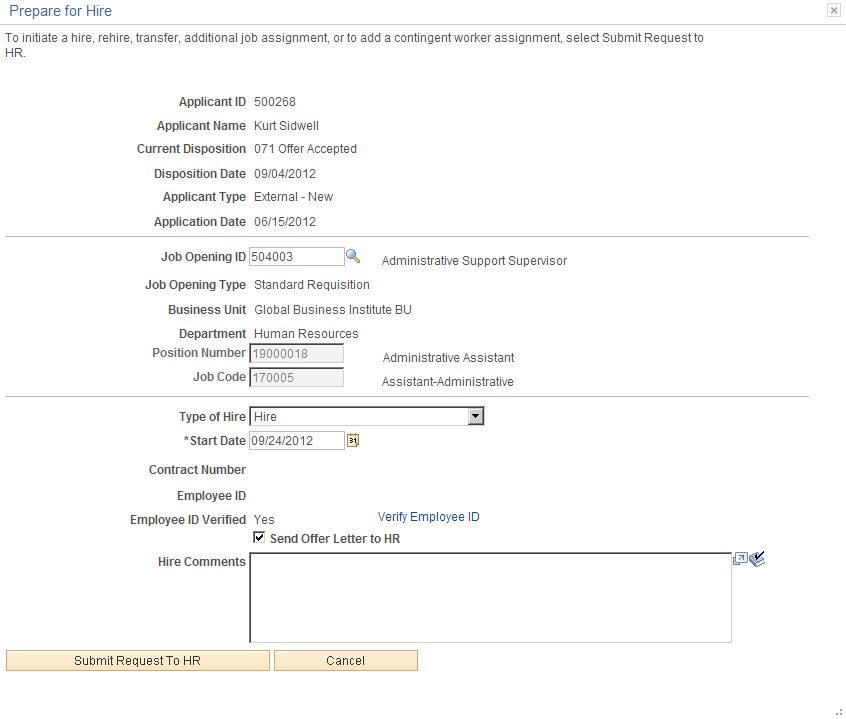

Use the Prepare For Hire page (HRS_PREP_FOR_HIRE) to review and complete job information and submit the hire request to the HR system.
Note: The Prepare For Hire action is available only for applicants whose disposition is Offer Accepted, Ready to Hire, Hired, or Withdrawn.

This example illustrates the Prepare For Hire page.
Applicant Information
The read-only fields at the top of the Prepare for Hire page identify the applicant and show the applicant’s disposition, disposition date, applicant type, and application date.
Job Opening Information
Field or Control |
Description |
Job Opening ID |
Identify the job opening for which the applicant is being hired. The default is the job opening for which you are performing the Prepare for Hire action, but you can change this value. |
Job Opening Type |
Displays the type of the selected job opening: Standard Requisition or Continuous Job Opening. |
Business Unit |
Displays the business unit of the selected job opening. |
Department |
Displays the department, if any, of the selected job opening. |
Position Number |
Displays the position number, if any, from in the latest accepted offer. If there is no position in the offer, then the primary position for the job opening appears. If the job opening does not have a position number, or if it has multiple position numbers, then you can select a value for this field. If your system is configured to use full position management, this field is required. If your system is configured to use partial position management, this field is optional. |
Job Code |
Displays the job code, if any, from the latest accepted offer. If there is no job code in the offer, then the primary job code for the job opening appears. You can select another job code if more than one job code is associated with the job opening. If the hire request does not specify a job opening or a position number, enter a job code directly into this field. You cannot submit a hire request without a job code. |
Additional Hire Information
Field or Control |
Description |
Type of Hire |
Select the type of employment. The available options depend on the applicant type. For external applicants you can select Hire and Add Contingent Worker. If the applicant is identified as a previous employee, either by the Verify Employee ID process or by the a Yes value in the Are You A Former Employee field on the Application Details Page, then the Rehire option appears instead of the Hire option. For non-employee applicants (persons of interest or contingent workers), you can select Hire and Add Contingent Worker. For internal applicants (employees), you can select Hire, Add Concurrent Job, Add Contingent Worker, or Transfer. |
Start Date |
Select the date on which the applicant is to begin work. |
Contract Number |
If you set up an applicant contract using the Manage Applicant Contracts action, this field displays the contract number. |
Employee ID |
If the applicant is an employee or non-employee person of interest, this field displays the applicant’s employee ID. If the applicant is external, this field is initially blank. If you match the applicant record to an employee record after clicking the Verify Employee ID link, the employee ID is displayed. |
Employee ID Verified |
Displays No if you have not yet clicked the Verify Employee ID link, or Yes after you click the Verify Employee ID link. |
Verify Employee ID |
Click to search the human resource database to see if the applicant is a former employee, contingent worker, or person of interest. This verification helps you avoid entering the same person into the system more than once. |
Send Offer Letter to HR |
Select this check box if you want the system to include the job offer letter in the hire request message that it sends to the HR system. If multiple offers exist, the system includes the letter from the offer that is in Accepted status. If you send the job offer letter, the Manage Hires Detail page in PeopleSoft Human Resources displays a link to the offer letter. If you select this check box, the system confirms the existence of a job offer letter when you submit the hire request. If there is no offer letter to send, you can choose to cancel the request or to submit it without an offer letter. If you submit the request without an offer letter, the system deselects the check box. This check box appears only if the Manage Hire Setup Page is configured so that the applicable hire type sends the offer letter to the HR system. |
Hire Comments |
Enter any comment that you want the HR administrator to see. |
Save & Submit Request to HR
Field or Control |
Description |
Submit Request to HR |
This button is visible only if the applicant has not yet been prepared for hire. Click to submit the hire request. The system sends a notification to the HR administrator, and the applicant appears in the Manage Hires component in Human Resources Administer Workforce. If the Recruiting Installation – Applicants Page is configure to require employee ID verification, and if you have not clicked the Verify Employee ID link, a message tells you that you must verify the employee ID before submitting. This message appears regardless of whether the applicant is already associated with an employee ID. |

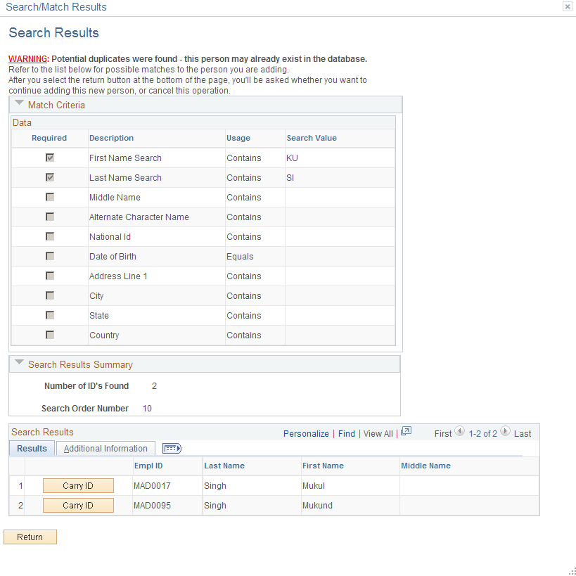

Use the Search Results page (HCR_SM_RESULTS) to review Search/Match results to determine whether the applicant was a former employee, contingent worker, or person of interest.

This example illustrates the Search Results page.
This is the common Search Results Page for searches performed by the search/match process. The page includes collapsible sections for reviewing the match criteria and a search results summary. The Search Results grid lists employees who meet the match criteria. Review the list for potential matches. If you are not sure whether an employee is a match, use the links on the Additional Information page to access additional information about the employee.
Buttons
Field or Control |
Description |
Carry ID |
Click to copy the employee ID to the Employee ID field on the Prepare for Hire page. |
Return |
Click to return to the Prepare for Hire page without bringing over an employee ID. |

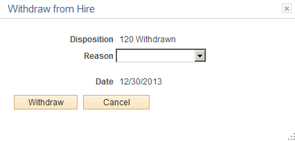

Use the Withdraw From Hire page (HRS_ACT_APP_WDRAW) to confirm that a hire request is being withdrawn, and send a cancellation request to the human resources system.
Note: This action is available only for applicants whose disposition is Ready to Hire and job openings that are in an open status.

This example illustrates the Withdraw from Hire page.
Field or Control |
Description |
Disposition |
Displays the disposition to be assigned. |
Reason |
If your organization has defined reasons for the Withdrawn status, select the appropriate reason. |
Date |
Displays the current date, which is also the date of the applicant's disposition change from Ready to Hire to Withdrawn. |
Withdraw |
Click to send the cancellation message to the human resources system. |
