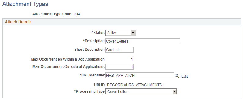

Use the Attachment Type Setup page (HRS_ATTACHTYPE_TBL) to define types of attachments for applications.
Navigation:
This example illustrates the Attachment Types page.
Field or Control |
Description |
Status |
Active attachment types are available for selection in both Candidate Gateway and Talent Acquisition Manager. If you want to make an attachment type unavailable in Candidate Gateway while keeping it available in Talent Acquisition Manager, enter 0 in the Max Occurrences fields to disallow the attachment type in Candidate Gateway. |
Description |
This description is used on the pages where applicants and recruiters upload attachments. |
Short Description |
This description is used on the Include Attachments Page, where a user selects the types of attachments to include in a routing request. |
Maximum Occurrences Within a Job Application |
Specify the maximum number of files with this attachment type that an applicant can attach to a specific job application:
When the maximum occurrences value is zero, the applicant does not see the attachment type in the list of available attachment types. Setting the maximum occurrences to zero lets you suppress an attachment type is a specific context. When a recruiter enters applicant data using Talent Acquisition Manager, this limit does not apply. |
Maximum Occurrences Outside of Applications |
Specify the maximum number of files with this attachment type that an applicant can upload on the My Activities page in Candidate Gateway. These attachments are not associated with individual job application. In Talent Acquisition Manager, these attachments are visible within all of the applicant’s applications.
URL Identifier |
Use the URL Identifier HRS_APP_ATCH for all application attachments. |
Edit |
Click the link to display the URL Maintenance page. Use the URL Maintenance page to:
The HRS_APP_ATCH and HRS_APP_ATCH_CG URL identifiers can have different file type restrictions, but they must have the same physical storage location so that application attachments are visible in both Candidate Gateway and Talent Acquisition Manager. |
URL |
Displays the URL address (the physical storage location for the attachments) for the selected URL identifier. |
Processing Type |
Identifies the processing type that controls how the system works with this type of attachment. The only processing type that can be used for more than one attachment type is Other. Use this processing type to set up any new attachment types that you need. |
