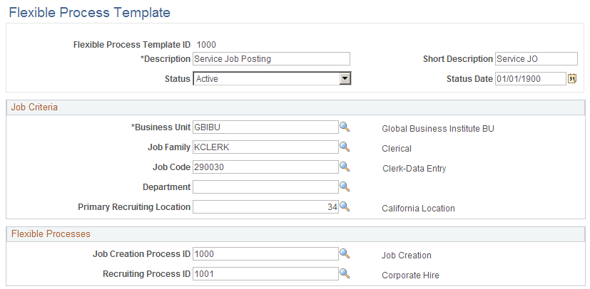

Use the Flexible Process Template page (HRS_FLXTMPL_DEFN) to associate flexible processes with job opening criteria.

Field or Control |
Description |
Flexible Process Template ID |
Displays a system-assigned unique identifier for this template. |
Description and Short Description |
Enter descriptive identifiers for the template. The system displays the full description when you search for templates or when you reference a template from a template group. |
Status and Status Date |
Indicate whether the definition is Active or Inactive, and enter the date that the status was assigned. Only active templates are available for selection in flexible template groups. If a template is already in use and then you inactivate it or set its active date to the future, the system still enforces the template’s flexible processes. |
Job Criteria
Use the fields in this section to define the contexts in which specific flexible processes are used. For example, if you created processes to be used for a specific business unit or department, identify the business unit and department in these fields.
Note: Changes to a job opening’s Business Unit, Job Code, Department, or Primary Recruiting Locations can affect which flexible process template governs the job opening. However, the system does not apply the new template until the next time the Job Opening component is opened.
Field or Control |
Description |
Business Unit |
Select the business unit for this template. This is a required field. |
Job Family |
Enter the job family for this template. If the Recruiting Installation - General Page does not have Job Family as the Template Segmenting Type, job openings are not associated with a job family. Therefore, you should leave this field blank. If the segmenting type is Job Family, remember that your recruitment templates can be associated with specific job families. If you specify a job family in a flexible process template, be the recruitment template that references the flexible process template is used for the specified job family. |
Job Code |
Enter the job code for this template. If the Recruiting Installation – Jobs Page is configured to allow multiple job codes in a job opening, the system uses only the primary job code when determining which flexible template to use. |
Department |
Enter the department for this template. |
Primary Recruiting Location |
Enter the primary recruiting location for this template. Job openings can have multiple recruiting locations, but the system uses only the primary recruiting location when determining which flexible template to use. |
Flexible Processes
Field or Control |
Description |
Job Creation Process ID |
Select the flexible job creation process to be just for job openings that match the specified job criteria. |
Recruiting Process ID |
Select the flexible recruiting process to be just for job openings that match the specified job criteria. |

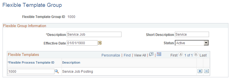

Use the Flexible Template Group page (HRS_FLXTMPLGRP_DFN) to define a group of related flexible process templates that can be associated with a recruitment template.
Navigation:
This example illustrates the Flexible Template Group page.
Field or Control |
Description |
Flexible Template Group ID |
Displays a system-assigned unique identifier for this template group. |
Enter descriptive identifiers for the template group. The system displays the full description when you search for template groups and when you reference a template group from a recruitment template. |
Effective Date and Status |
Indicate whether the definition is Active of Inactive, and enter the date that the status was assigned. Only templates that are active as of a recruitment template’s effective date are available for selection in the recruitment template. |
Flexible Templates
Field or Control |
Description |
Select one or more flexible process templates to use for job openings that are associated with this flexible template group. Be sure to thoroughly analyze the interaction of the job criteria fields on the flexible templates that belong to the same group. |
