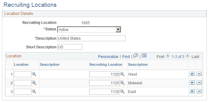

Use the Recruiting Locations page (HRS_LOCATION) to define the geographical categories that will be exposed to applicants, and associate those recruiting-specific locations with physical locations and with other lower-level recruiting locations.
Navigation:
This example illustrates the Recruiting Locations page.
Every recruiting location should be associated with at least one location or recruiting location. Do not leave the Location grid empty.
Note: In each row, select either a physical location or another recruiting location, but not both.

Location |
Select the physical location that is associated with the recruiting location. Define physical locations on the Location Address Page. |
Recruiting Location |
Select a recruiting location that is a subset of the current recruiting location. Do not associate a recruiting location with itself. Nested recruiting locations appear as hierarchical facets on the Candidate Gateway job search page and on the Browse Job Openings Page. The hierarchical facets for recruiting location are limited to five levels (the top level and up to four levels of nested recruiting locations). Therefore, the best practice is to avoid nesting recruiting locations any deeper than that. |
