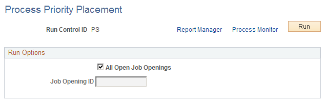

Use the Process Priority Placement page (HRS_RUN_PR_PL) to run the RS-Priority Placement process on one job opening or all open job openings.

This example illustrates the Process Priority Placement page.
Field or Control |
Description |
All Open Job Openings |
Select this check box to run the RS - Priority Placement process on all job openings with an Open status. If you select this check box, the Job Opening ID field is unavailable. |
Job Opening ID |
If you do not select the All Open Job Openings check box, enter the ID for a single job opening that you want to process. |
Run |
Click to access the Process Scheduler Request page, where you schedule the process. |
