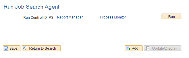

Use the Job Search Agent page (HRS_RUN_JOBAGNT) to run the Job Agent process.
Navigation:
This example illustrates the Run Job Search Agent page.
This run control page does not have any parameters.
Click Run to access the PeopleSoft Process Scheduler Request page, where you schedule the Job Agent process.
Note: The best practice is to set up the request so that the Job Agent process runs at regular intervals.
