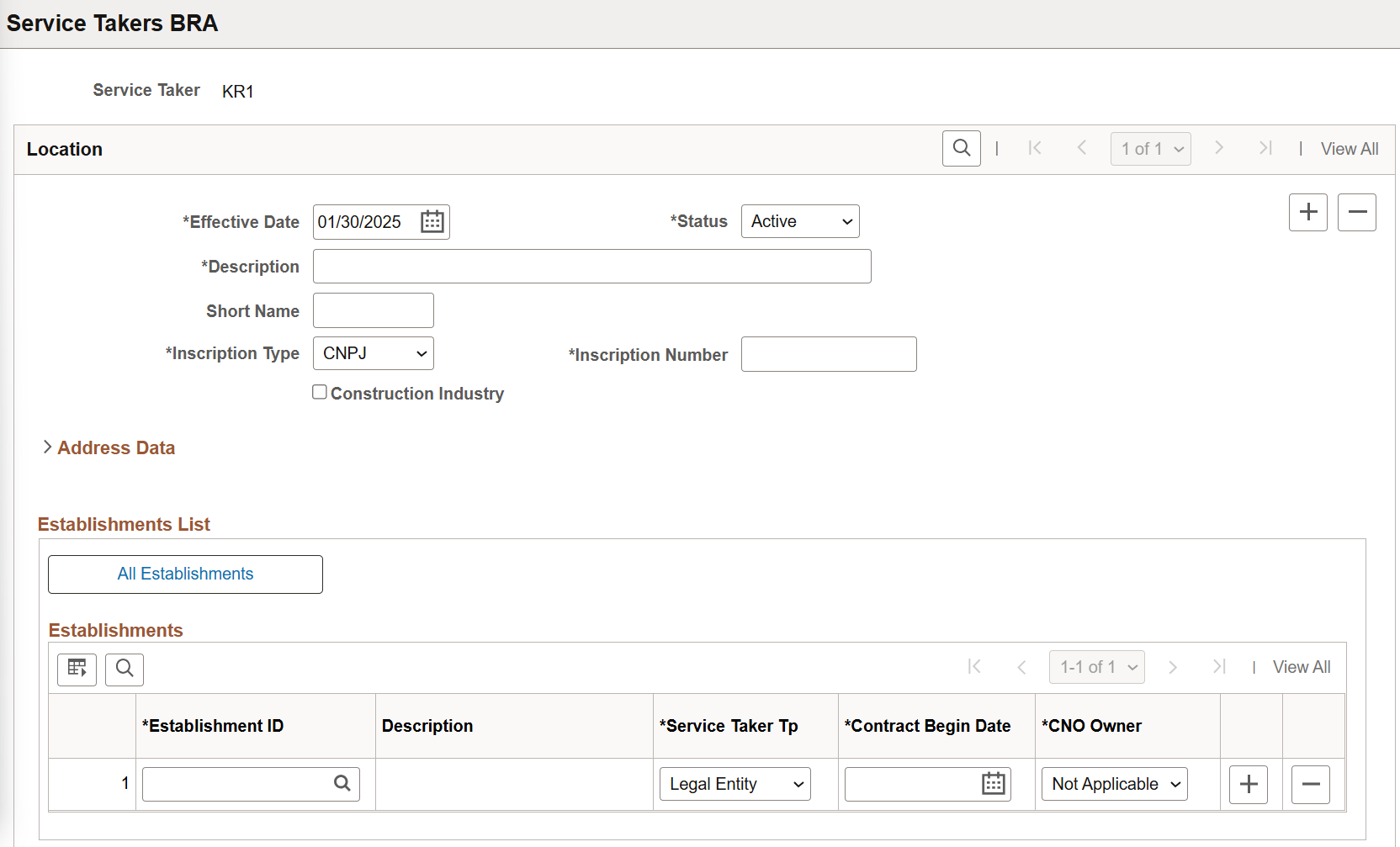

Use the Service Takers BRA page (GPBR_SERVICE_TAKER) to set up service takers to use for data entry purposes.
Both SEFIP and eSocial reports use service taker information.
Navigation:
Set Up HCM > Product Related > Global Payroll & Absence Mgmt > Framework > Organizational > Service Takers BRA > Service Takers
This example illustrates the fields and controls on the Service Takers BRA page.
Location
Field or Control
Description
Inscription Type
Select the type of ID that identifies the service taker. Values are CEI, CNPJ (default), and CPF.
Inscription Number
Enter the ID of the specified inscription type that identifies the service taker.
Establishments List
Field or Control
Description
All Establishments
Click this button to add all of the valid establishments for a service taker. The Establishments region enables you to define the relationship between service takers and establishments.
Establishments
Field or Control
Description
Service Taker Tp (service taker type)
Select the type of service contracted by the establishment, which is legal entity, according to eSocial requirements.
Contract Begin Date
Enter the date when the contract between the establishment and the service taker began.
By default, the system populates this field with the service taker’s effective date (currently displayed on the page), or the earliest effective date of the establishment, whichever is the latest.
This information is used in eSocial reporting.
CNO Owner
Select the CNO or CEI responsible. Values are:
Estab (establishment)
Not Applicable (default)
Other CNPJ. If selected, the CNPJ Owner field becomes available for edits.
Other CPF. If selected, the CPF Owner field becomes available for edits.
Service Taker
Note: This field is required only if the service taker is related a construction establishment with partial contract.
CNPJ Owner or CPF Owner
Enter the CNPJ or CPF register number of the CNO owner. This value is required if Other CNPJ or Other CPF is selected in the CNO Owner field.
