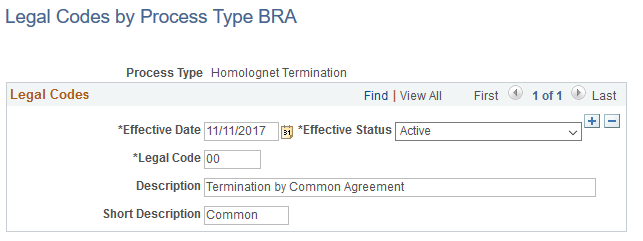

Use the Legal Codes by Process Type BRA page (GPBR_RPT_CD) to define process type legal codes.
Navigation:
This example illustrates the fields and controls on the Legal Codes by Process Type BRA page.
The system delivers the 00 legal code for the Homolognet Termination process type to support the reporting of terminations by agreement. When the Termination Contract report (the TRCT type) is run, the system populates the Causa do Afastamento field of the report with the description text that is specified in this legal code, and leaves the Cod. Afastamento field blank.

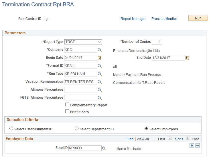

Use the Termination Contract Rpt BRA (termination contract report BRA) page (GPBR_RC_TER_CON) to run the Employment Contract Termination report.
Navigation:
This example illustrates the fields and controls on the Termination Contract Rpt BRA page.
Field or Control |
Description |
Report Type |
Select a report type to run, THRCT, TQRCT, TRCT, or run all of them. |
Begin Date and End Date |
Enter a date range. The system will select only records falling on or between these dates. |
Format ID |
Select the element list that contains all the required earnings and deductions that need to be printed, for example, KRDEMPGTO. |
Run Type |
Select the termination run type. |
Vacation Remuneration |
Select the accumulator that contains the total amount for termination compensation purposes. TR REM TER RES is provided as an example for this accumulator. |
Alimony Percentage |
If the employee has any garnishment, such as alimony, and you would like to print the percentage that the employee pays, you need to provide a variable element name. TR VR %PEN ALIM is provided as an example of a variable element. You need to override this variable at the payee level to assign a percentage at the payee level. |
Select Establishment ID and Establishment ID |
Select to report on all dismissed employees from selected establishments. Enter the establishment IDs in the Establishment Data group box. |
Select Department ID, Set ID, and Department ID |
Select to report on all dismissed employees from selected departments. Enter the setIDs and department IDs in the Department Data group box. |
Select Employees and Empl ID |
Select to report on selected employees. Enter the employee IDs in the Employee Data group box. |
