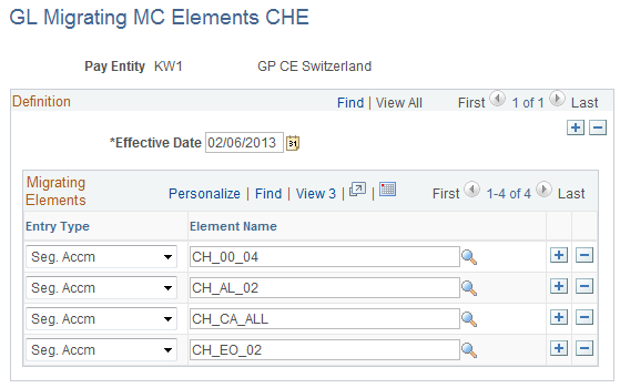

Before running this process, you must access the GL Migrating MC Elements CHE page and list the segment accumulators to migrate from the legal record to the target record and company specified in the segment accumulators' User Key fields.

Select the segment accumulators to transfer to the target record where they can be picked up and processed by General Ledger.
To do this, use the GL Migrating MC Elements CHE page.

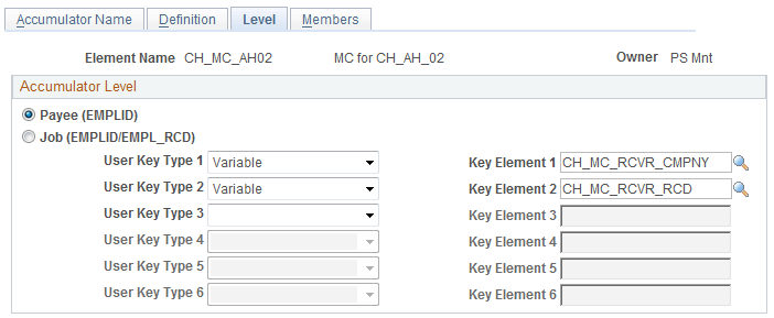

Specify the variables storing the record number and company to which you want to transfer segment accumulator results in the accumulators' User Key fields.
Do this on the Level page of the Accumulators (GP_ACCUMULATOR) component in the core application.

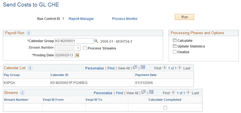

Send the accumulator results to PeopleSoft General Ledger.
Do this on the General Ledger Run Control page.

Use the GL Migrating MC Elements CHE (General Ledger Migrating Multiple Contracts Elements CHE) page (GPCH_GL_MIGR_LST) to select segment accumulators to transfer to a target record where they can be picked up by the GL process.
Navigation:
Field or Control |
Description |
Entry Type |
Select Seg. Accm (segment accumulator). |
Element Name |
List the segment accumulators to transfer from the legal (receiving) record to the target record for GL processing. |
Use the Level page (GP_ACCUMULATOR_1) to specify the variables storing the record number and company to which you want to transfer segment accumulator results.
We discuss this page in the PeopleSoft Global Payroll PeopleBook.
Navigation:
Level page
In the User Key Type fields, select Variable, and then enter the variable element CH_MC_RCVR_CMPNY (MC Receiver Company) in combination with the variable CH_MC_RCVR_RCD (MC Receiver) in the Key Element fields. These variables are set up to hold the company and the number of the target record to which you are transferring the segment accumulator results.
Note: We discuss this page in detail in the PeopleSoft Global Payroll PeopleBook.
Use the Send Costs to GL CHE page (GP_GL_PREPARE) to send costs to PeopleSoft General Ledger.
When you run the General Ledger process from this page, the system transfers accumulator results to the target record and company stored in the variables specified on the segment accumulator Level page and then sends the results to PeopleSoft General Ledger.
Navigation:
The fields on the General Ledger Run Control page for Switzerland are identical to those on the Send Costs to GL page in the Global Payroll core application.
