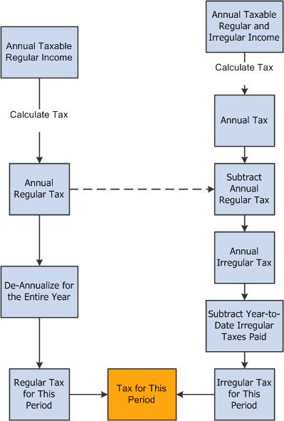

When calculating personal income tax for declaration to the Revenue Department, there are two tax calculation methods to choose from: the Calculation In Advance Method (CAM) and the Accumulative Calculation Method (ACM).
CAM is the method that the Revenue Department recommends employees use. Most companies use ACM to calculate taxes, but governmental organizations still use CAM to calculate the taxes for their officers.
Global Payroll for Thailand enables organizations to choose either calculation method. Both ACM and CAM follow the same high level processing flow as shown in the following graphic:
This image illustrates the high-level processing flow that both the Accumulative Calculation Method or ACM, and Calculation In Advance Method or CAM, calculation methods follow.
The difference between the two tax calculation methods is in the detailed processing steps, such as annualizing regular taxable incomes, and de-annualizing the total calculated tax.

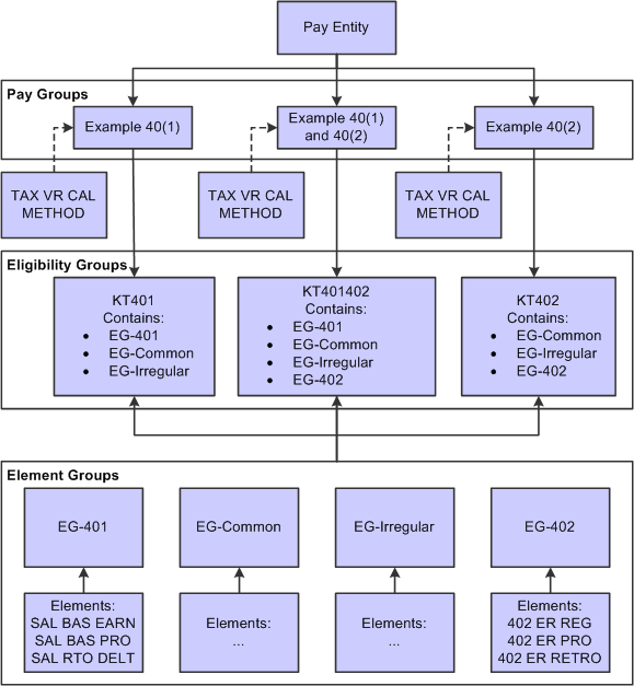

The following diagram illustrates a typical organizational structure for Global Payroll for Thailand:
This diagram describes a typical organizational structure for Global Payroll for Thailand.
In the previous graphic, a pay entity is the business organization that pays payees.
Pay groups combine payees with the same frequency, same pay periods and same payment dates during a payroll process. You must define at least one pay group for each typical pay frequency used in your organization.
The pay groups described in the previous graphic are not delivered in PeopleSoft Global Payroll for Thailand. The example pay groups illustrate three different income streams:
Section 40(1) income only in the Example 40(1) pay group.
A mix of Section 40(1) and Section 40(2) income in the Example 40(1) and 40(2) pay group.
Section 40(2) income only in the Example 40(2) pay group.
TAX VR CAL METHOD is the element user key that specifies the tax calculation type, Withholding, Gross Up One Cycle, or Gross Up All Cycles.
PeopleSoft Global Payroll for Thailand delivers the following eligibility groups that specify which types of regular income a payee receives:
KT401 is the eligibility group for Section 40(1) income.
KT401402 is the eligibility group for a combination of Section 40(1) and Section 40(2) income.
KT402 is the eligibility group for Section 40(2) income.
Global Payroll for Thailand delivers the following element groups:
EG-401.
Contains the SAL BAS EARN, SAL BAS PRO, and SAL RTO DELT elements for processing of Section 40(1) income.
EG-Common.
Contains all common earning and deduction elements, which are eligible to all pay groups. For example, deduction elements for tax allowance, social security contribution and provident fund contribution are eligible to all payees.
EG-Irregular.
Contains all earning elements for irregular income. This element group is eligible to all pay groups. The 'Eligibility Assignment' of all members of this element group will be set to 'By Payee'. By this means, if you want a payee gets an element processed, you have to assign this element through the payee level Earnings/Deductions Assignment page or enter positive input. This guarantees those elements that are not only eligible to the current payee, but also have been assigned through positive input or element assignment will be resolved. This can greatly improve system performance.
EG-402.
Contains the 402 ER REG, 402 ER PRO, and 402 ER RETRO elements for processing Section 40(2) income.

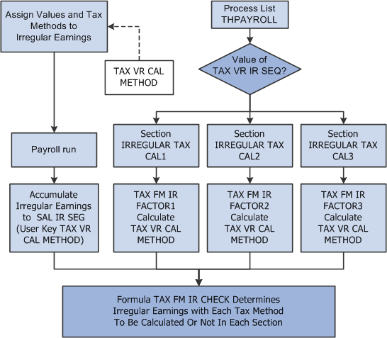

Determining Tax Calculation Types for Irregular Income
The tax calculation methods of irregular income are determined through positive input or element assignment while assigning values to irregular incomes.
The following diagram illustrates how to determine the tax calculation types and sequences for irregular income:
This diagram illustrates how to determine the tax calculation types and sequences for irregular income.
Although a single type of irregular income can use any of the three tax calculation types, Global Payroll for Thailand delivers one earnings element for each type of irregular income. Use the following steps to identify the tax calculation type for each type of irregular income:
Add the TAX VR CAL METHOD variable to each irregular income earning element as a user key.
Enter one of the tax calculation types in the TAX VR CAL METHOD variable through positive input or the Earning/Deduction Assignment page.
Use the Configuration by Element page or the Configuration by Category page to ensure that the end user assigns a value to the TAX VR CAL METHOD variable.
Add the TAX VR CAL METHOD variable as a user key for the related accumulators.
Since a payee can have all of the tax calculation types on irregular income during the same period, the pay group cannot be used to determine which tax calculation method should be used for a given irregular income. All earnings elements for irregular income use the TAX VR CAL METHOD user key to indicate which tax calculation type to use. Payroll administration needs to assign a value to this user key using supporting element overrides when entering irregular income using Positive Input or the Earning/Deduction assignment page.

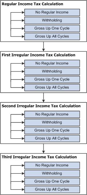

The Global Payroll for Thailand process list has four sections for tax calculation:
Regular Income Tax Calculation.
This section calculates the personal income tax for regular income. Based on the current payee's type of regular income, this section chooses the tax calculation type to calculate the regular tax.
First Irregular Income Tax Calculation.
A payee can have three different types of irregular income within one payroll period: withholding, gross up all cycles and gross up one cycle. There are three separate sections to calculate different types of irregular incomes. Based on the configuration, this section can calculate withholding, gross up all cycles, and gross up one cycle irregular income taxes. If the organization specifies that this section calculates withholding tax, but the current payee does not have any withholding irregular income, then this section is skipped.
Second Irregular Income Tax Calculation.
You can specify the tax calculation type for this section.
Third Irregular Income Tax Calculation.

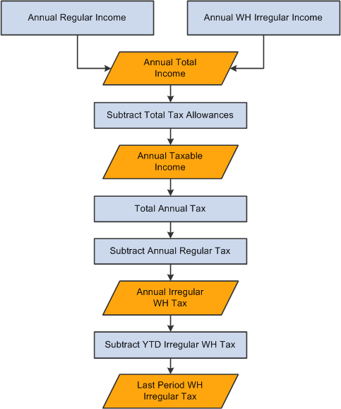

Calculation Logic In the Last Period of One Tax Year
The irregular tax calculation process in the last period of the tax year differs from the process during other periods of the year. For example, assume that the irregular tax calculation sequence is:
Withholding.
Gross up all cycles.
Gross up one cycle.
The following diagram shows the process flow for calculating the withholding tax in the last period of the year:
This diagram shows the process flow for calculating the withholding tax in the last period of the year.

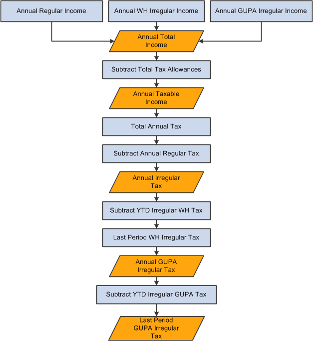

Then, the gross up all cycles irregular tax is calculated based on the withholding tax results:
This diagram shows that the gross up all cycles irregular tax is calculated based on the withholding tax results.
