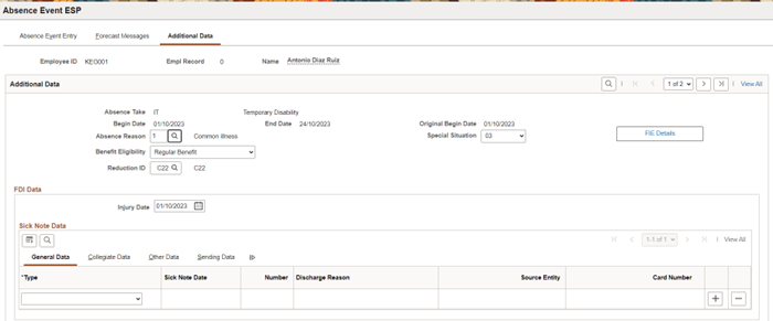

Use the Additional Data page (GPES_ABS_EVENT_ADD) to enter sick note, confirmation note, or medical discharge note data prior to generating the FDI medical report text file for the social security agency.
Navigation:

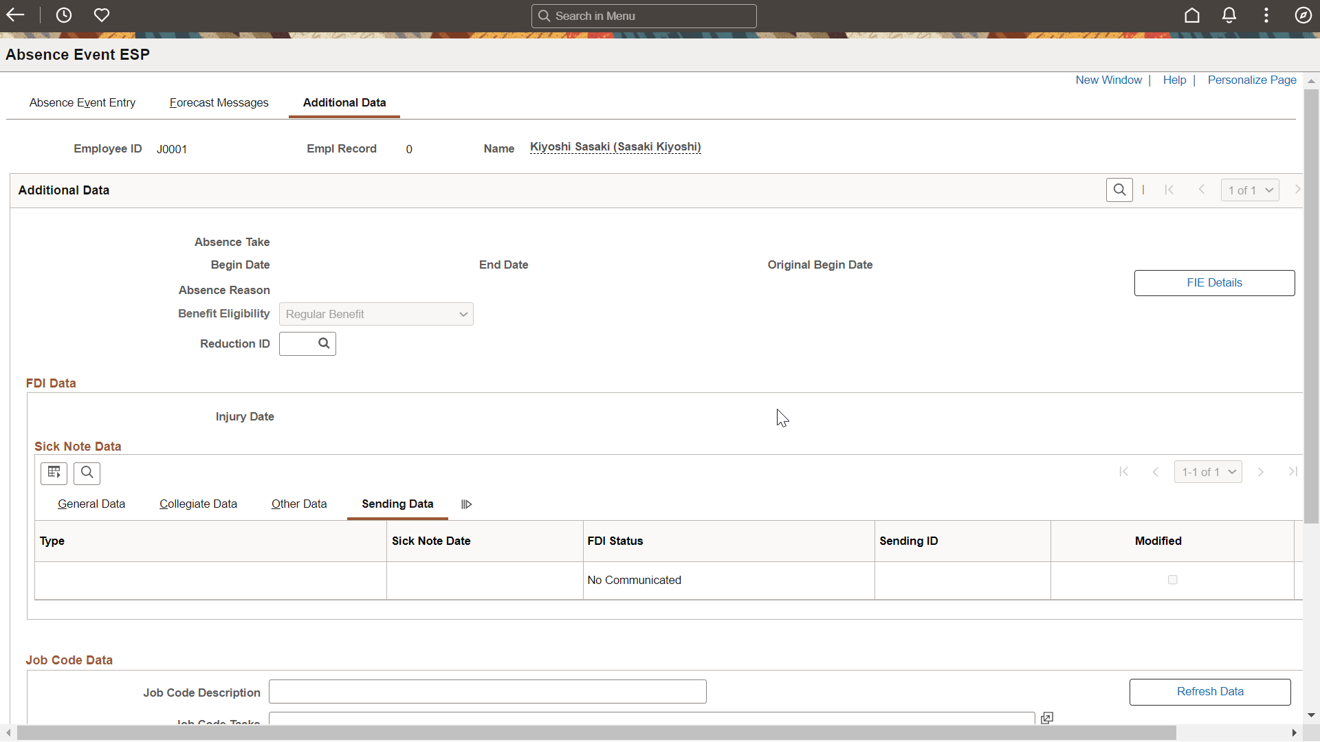

This example illustrates the fields and controls on the Additional Data page.
This example illustrates the fields and controls on the Additional Data - Collegiate Data tab. You can find definitions for the fields and controls later on this page.

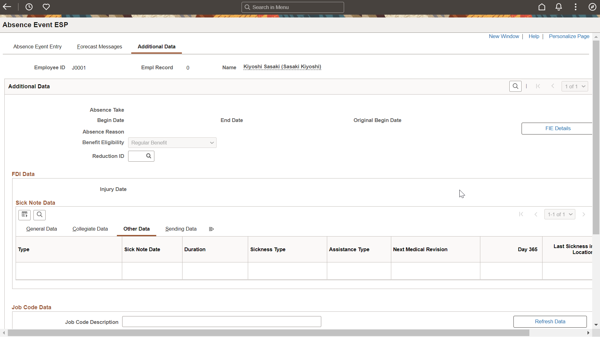

This example illustrates the fields and controls on the Additional Data page - Other Data tab. You can find definitions for the fields and controls later on this page.
This example illustrates the fields and controls on the Additional Data page - Sending Data tab. You can find definitions for the fields and controls later on this page.
Additional Data

FDI Data - General Data tab
Use the fields in this group box to select an injury date and enter information about the different note types that must be tracked in the FDI medical report text file.
When creating absences:
The absence events are created using Component Interface, which is similar to creating them manually. The only difference is that absences created automatically will have the field Entry Source=Third Party.
For all absences with type: DIS, the system also generates the sick note, which is required for the FDI economic data communication (DE).
Note: System identifies if the absence is managed by self-Insurance company or not, by using information contained in the FIE file. In particular, the field ‘Entidad Responsable’ of the segment DIT. When that field is informed with value 666 EMPRESA COLABORADORA, we won’t create any sick note as the expectation is that company will have the information to create the PA, PC, PB notes.
Field or Control |
Description |
Injury Date |
Enter the specific date on which the injury or accident occurred. Note: This field is relevant only for AT/EP absence takes. |
Type |
Select a note type. In case of temporary disability, the valid values are:
Other values are:
Sick Note Date |
Number |
Enter the order of a series of confirmation notes. For example, enter 1 for the first confirmation note, 2 for the second confirmation note, and so on. Note: Because confirmation notes are the only notes that can be received more than once over the course of a temporary disability, this field does not apply to other note types. |
Discharge Reason |
Select the reason for a medical discharge. Note: This field is available for data entry only when the note type is PA - Medical Discharge. |

FDI Status |
Displays the status of the FDI file. The valid values are:
Note: If the status is Included in FDI or FDI Sent Confirmed, the Sending ID field shows the identifier of the transmission and you can select the Modified check box to edit the information in the Sick Note. Once edited, the FDI status changes to No Communicated. |
Sending ID |
Displays the identifier of the communication. This needs to be a unique identifier. The system generates this ID when you run the Create FDI File process on the Create FDI File ESP page. Note: The sending ID enables you to track the transfer of data to the social security agency. |
Modified |
Select to indicate that you have modified information related to a note after the note has been confirmed and sent to the social security agency. When you select the Modified check box, the system deselects the Confirmed check box and you can reprocess and resend the medical note data on the Create FDI File ESP page. Note: You can also un-confirm the data contained in an FDI medical report text file by clicking the Unconfirm button on the FDI Confirmation ESP page of the FDI Confirmation ESP (GPES_FDI_SEND) component. |
