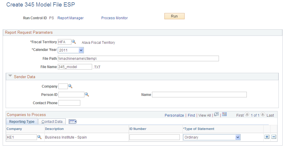

Use the Create 345 Model File ESP page (GPES_RC_TAX_345) to run the Model 345 application engine process (GPES_TAX_345), generating the Model 345 file and the related summary file.
Navigation:
This example illustrates the fields and controls on the Create 345 Model File ESP page. You can find definitions for the fields and controls later on this page.
Report Request Parameters
Field or Control |
Description |
Fiscal Territory |
Select the state fiscal territory for which you are generating the model file. The system prompts you to select from the available tax locations. Note: If you select the HE (State Fiscal Territory) value in this field, the Sender Data group box becomes unavailable. |
Calendar Year |
Select the calendar year for which you are generating the model file. |
File Path |
Enter the path where you want the process to store the model file. |
File Name |
Enter the file name that you want the process to use for the model file. The system stores the data in text (.txt) format. |
Sender Data
Companies can manage their own tax reporting or give that responsibility to another company. In cases in which one company is sending information for other companies, use this group box to enter contact data for the company that is sending the information. Then use the Contact Data tab in the Companies to Process group box to enter the contact information that is specific to each company. If you are sending data for your own company only, leave this group box blank and enter contact information only on the Contact Data tab.
Note: This group box is unavailable if you select the HE value in the Fiscal Territory field.
Field or Control |
Description |
Company |
Enter the name of the company that is sending the model file. |
Person ID |
Enter the ID of the person who is sending the model file. |
Name and Contact Phone |
Enter the name and contact phone number of the person who is sending the model file. |
Companies to Process - Reporting Type
Field or Control |
Description |
Company |
Select the companies for which you are sending the model file. The process creates a report for each company that you specify. |
Description |
Displays the name of the selected company. |
ID Number |
Enables you to manually enter the Número Identificativo de la Declaración for the report. |
Type of Statement |
Select the type of model statement that you want to generate. Values are: Ordinary: Select to process all employees for the selected calendar year. Complementary: Select to process specific employees who were not included in the processing of the ordinary statement. The system displays an Employees link to select the specific employees to process, and a Related ID Number field to enter the ID of the related model file previously generated through ordinary processing. Substitute: Select to generate a substitute model file to replace a previously generated file. Use this option when new information is available to send for employees of a previously generated file. The system displays a Related ID Number field to enter the ID of the related model file previously generated. |
Related ID Number |
The system displays this field when the statement type is either complement or substitute. Enter the ID of the previously generated model file that you want to complement with more employees or substitute with new data. |
Employees |
Click to access the Employees to Process page, where you can select the employees for the system to process. The system displays this link only if you select to process a complementary type of statement. When the system displays the Employees to Process page, use the EmplID field to select the employees whom you want to include in the model file. The system enables you to select only the employees who belong to the company being reported. |
Companies to Process - Contact Data
Use this tab to enter the contact information for each of the companies for which you are sending the model file.
Field or Control |
Description |
Employee ID |
Enter the ID of the person who is the contact for the model file at the company. |
Contact Name |
Enter the name of the person who is the contact for the model file at the company. |
Contact Phone |
Enter the contact phone number of the person who is the contact for the model file at the company. |
