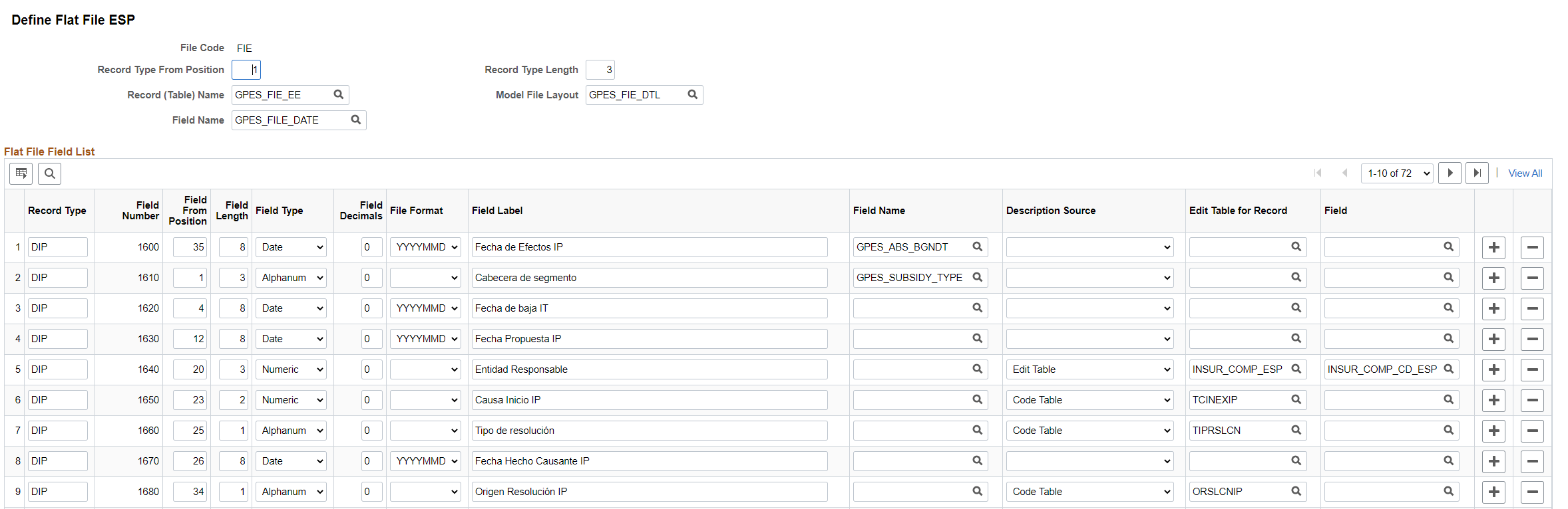

Use the Define Flat File ESP page (GPES_FLT_FILE_DEFN) to:
Define the primary record that will be filled during the loading process and will contain one row per employee and record type.
Define the secondary record that will contain whole information of the file, in the format of one row per employee/label in the input file.
Define the positions in the file that will identify the type of the record.

This example illustrates the fields and controls on the Define Flat File ESP page. You can find definitions for the fields and controls later on this page.
Field or Control |
Description |
Record Type From Position and Record Type Length |
Enter the position and length to identify the type of the record. |
Record (Table) Name |
Select the record table name. This is the primary record that will be filled during the loading process. |
Field Name |
Select the field in the primary record that will be mapped with that piece of information in the file. Note: Key field name used to delete previously loaded data. Before starting to load data for a new value, the data is deleted for such a new value from both the primary and secondary table |
Model File Layout |
Select the model file. This is the secondary record that will contain whole information of the file. |
Flat File Field List
Field or Control |
Description |
Record Type, Field Number, Field From position, Field Length, Field Decimals |
Enter the file details such as Record Type, Field Number, Field From Position, Field Length and Field Decimals. |

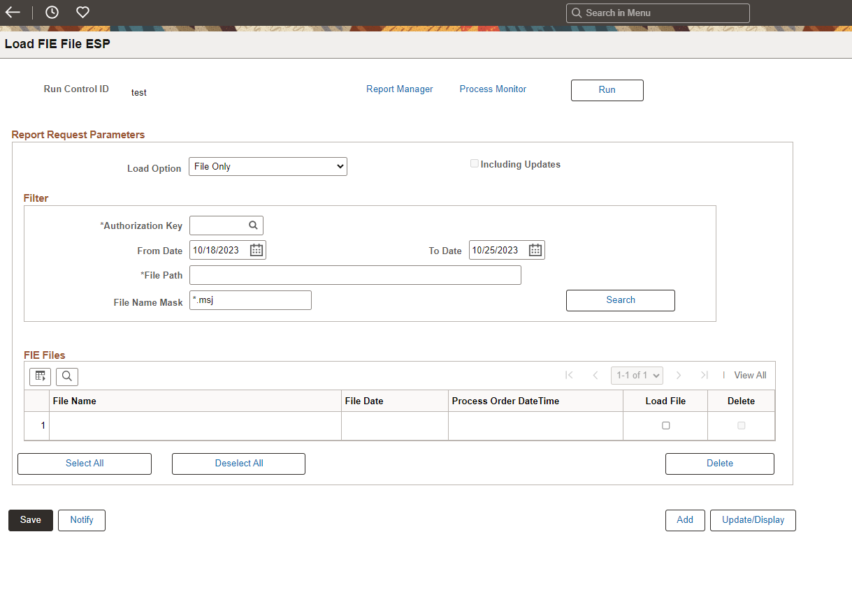

Use the Load FIE File ESP page (GPES_RC_FIE) to load the data from the FIE file. This page enables the user to load the content of multiple FIE files at once without the need to upload the files themselves. You can also delete the data previously loaded as part of clean-up process.
Navigation:
This example illustrates the fields and controls on the Load FIE File ESP page. You can find definitions for the fields and controls later on this page.

Load Option |
Select the required value from the drop-down list. Values in the list are:
When the user selects ‘File and Absences’, then the field Including Updates becomes available. When 'File Only' is selected, only FIE records are populated. |
Including Updates |
Select this check box if you want the system to update existing absence events, with the latest information coming in the FIE file. |
Authorization Key, File Name Mask, From Date and To Date |
Select Authorization Key, Date Range and File Name Mask. |
File Path |
Enter the path to the folder that contains FIE files. Note: Ensure to copy the received FIE files in a folder that is visible from the Process Schedule. |
Search |
When you click the Search button, the system will look for the files matching the File Name Mask placed in the specified path with modified date within the range of dates that has been entered. Then for those files the system verifies that authorization key match with the one in the filter and that file date falls also in the range on dates. |
Load File |
FIE Files section lists all the files, either loaded or pending to be loaded. For the files still not loaded into the system the Load File check box will be editable. |
Delete |
Select this check box if you want to delete the content of the tables in the application that contained the data from the specific file. Delete option can be used to clean-up data that is not useful anymore, or to be able to re-load a file. |
Run |
Use the Run button to load the content of the FIE files. |

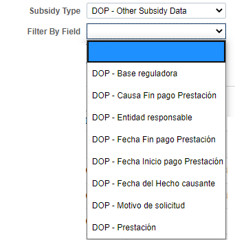

Company, SSN Employer, Employee, Absence Type, Subsidy Type |
You can filter the data based on Company, SSN Employer, Employee, Absence Type, Subsidy Type or any data present in the file. |
Filter By Field |
Select the field based on which you want to filter the data. Note: The displayed list depends on the Subsidy type being selected. |
Filter By Field options

Show discrepancies only |
You can also view those rows corresponding to absences that are not matching with the ones in the system (Absence Event ESP). To list the rows that are not matching, select the Show Discrepancies only check box. |

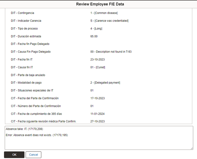

Details |
Use the Details link in each row to view the complete content of the corresponding FIE file record type. Click the link to open the Review Employee FIE Data page. It is also possible to review the messages populated during validation process or while creating/update absences. |

This example illustrates the Review Employee FIE Data page.
If there are any anomalies during the validation process, the system displays an error message section.
