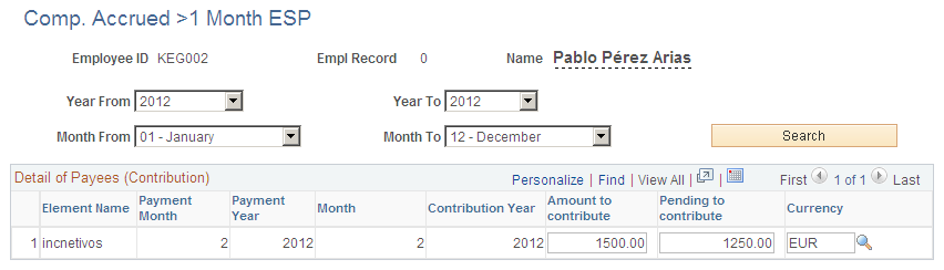

Use the Comp. Accrued >1 Month ESP (compensation accrued over more than one month) page (GPES_FUT_CNTRB) to view compensation accrued over more than one month.
Navigation:
This example illustrates the fields and controls on the Comp. Accrued >1 Month ESP (compensation accrued over more than one month) page. You can find definitions for the fields and controls later on this page.
Field or Control |
Description |
Year From and Year To |
Enter the range of years over which you want to view compensation. |
Month From and Month To |
Enter the range of months over which you want to view compensation. |
Search |
Click to display compensation accrual information for the year and month range you specified. |
Details of Payee (Contribution)
This group box displays detailed information about accrued compensation for the payee. You can modify the amounts in the Amount to contribute and Pending to contribute fields.
