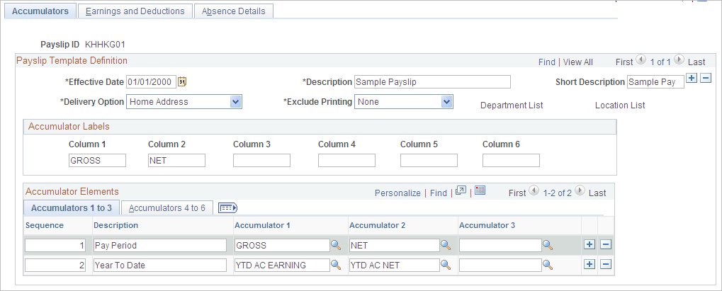

Use the Accumulators page (GPHK_PSLP) to set up delivery and print exclusion options, column headings (labels), and column contents (rows of accumulators).
Navigation:
This example illustrates the fields and controls on the Accumulators page. You can find definitions for the fields and controls later on this page.

Field or Control |
Description |
Payslip ID |
Select an ID to attach a single template to multiple pay groups. Note: Only one template can be attached to a pay group at one time. |
Payslip Template Definition
Field or Control |
Description |
Delivery Option |
Determines where the hardcopy payslips are sent. Select from a list of internal type addresses, such as department or location, or external addresses, such as home address and mail address, which are recorded in the payee's personal data record. Note: Use the Payslip Delivery Option HKG page to override the delivery destination of the printed payslip from the default delivery option that you select here. The Payslip Delivery Option HKG page is effective-dated to enable you to override the delivery option for a period of time. |
Exclude Printing, Department List, and Location List |
Select Location or Department to exclude the printing of specific departments or locations on your payslips. The corresponding links then become available and enable you to select the specific departments or locations that you don't want to display on the payslips during the print process. You can select multiple locations or departments. If you want to print a location or department that you previously excluded, you can override this on the Create/Print Payslips HKG page before you run the print process. Note: If you enter a pay entity as the reprint option on the Create/Print Payslips HKG page and you exclude a location that is part of that pay entity, it is not printed. |
Accumulator Labels
Enter the column heading labels for the accumulators that appear across the page on the printed payslip.
Accumulators 1 to 3 Tab
Access the Accumulators 1 to 3 tab.
Field or Control |
Description |
Sequence |
Enter a sequence number to set the order in which the accumulators appear. They appear in ascending order. |
Description |
Enter a description of each accumulator row. |
Accumulator 1, Accumulator 2, and Accumulator 3 |
Select the accumulators to display for the corresponding column. Accumulator 1 values appear under the column 1 label, accumulator 2 values appear under the column 2 label, and so on. For example, you might have already have entered a description of sequence 1 and 2 as current and year to date. If you also want to display quarter-to-date accumulated amounts, you must create a new row, give the new row the description value of QTD, and select the accumulators that correspond to the column headings (labels). |
Accumulators 4 to 6 Tab
Access the Accumulators 4 to 6 tab.
Set up accumulators 4 to 6 on this tab. This is the same as the Accumulators 1 to 3 tab, except that it doesn't have sequence or description fields because the same sequence number and description apply to all six accumulators in the row.

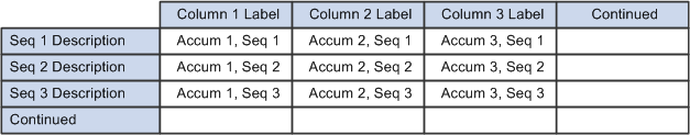

Accumulators on Printed Payslips
The following diagram shows how column labels, sequences descriptions, and accumulator numbers work together on the printed payslip:

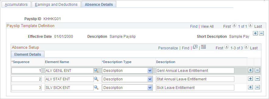

Use the Absence Details page (GPHK_PSLP2) to add absence entitlements and absence pro rata elements.
The payslip displays the current balance of the entitlement or pro rata.
Navigation:
This example illustrates the fields and controls on the Absence Details page. You can find definitions for the fields and controls later on this page.
Select the absence elements to display in the absence section of the payslip and the sequence in which these elements appear.
Use this page the same way that you use the Earnings and Deduction page. Enter a sequence number and an element name, and select one of three descriptions.
