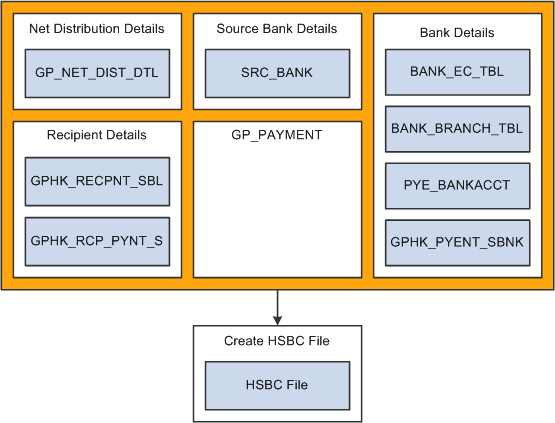

The following diagram shows the tables that contribute data to the HSBC file that is part of the EFT file:
Note: You must finalize your banking process (GP_PMT_PREPARE) before you can create the HSBC file. After the HSBC file has been created, the system changes PMT_STATUS on GP_PAYMENT from P (prepared) to T (transferred).
