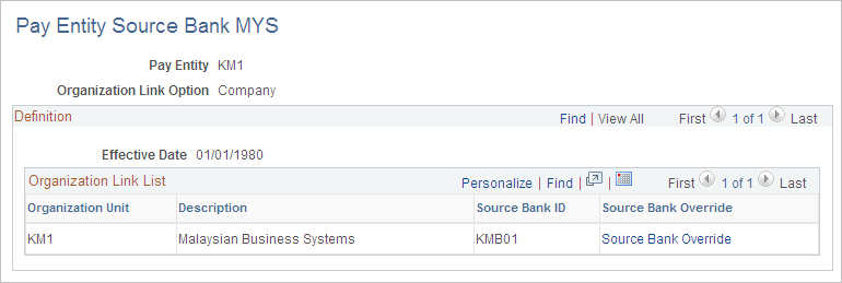

Use the Pay Entity Source Bank MYS page (GPMY_PE_SBANK_OVRD) to view information about the source bank that the system uses for a particular debit type for an organizational unit.
This information is entered on the Source Bank Link page.
Navigation:
This example illustrates the fields and controls on the Pay Entity Source Bank MYS page. You can find definitions for the fields and controls later on this page.
Field or Control |
Description |
Source Bank Override |
Click the Source Bank Override link to access the Source Bank Overrides group box. |

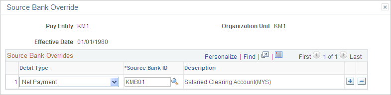

Use the Source Bank Override page (GPMY_PE_SBANK_SEC) to associate source banks with debit types for a particular organizational unit.
The read-only information on this page comes from the setup information on the Source Bank Link page of the Pay Entity component.
Navigation:
Click the Source Bank Override link on the Source Bank Override page.
This example illustrates the fields and controls on the Source Bank Override (by debit type) page. You can find definitions for the fields and controls later on this page.
Field or Control |
Description |
Debit Type |
Enter a debit type. Values are Net Payment and Recipient. |
Source Bank ID |
Enter the ID of the source bank that you use to pay the debit type. |

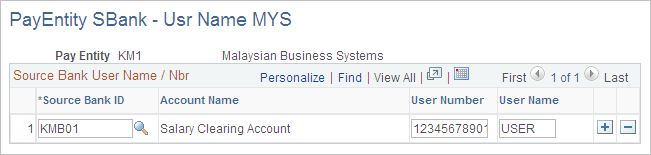

Use the PayEntity Sbank - Usr Name MYS page (GPMY_PYENT_BNK) to define the source bank, user name, and user number for a Malaysian pay entity.
Navigation:
This example illustrates the fields and controls on the PayEntity SBank - Usr Name page. You can find definitions for the fields and controls later on this page.
Every bank assigns a user number and user name to the pay entity's source bank ID. Use this page to enter these values into the system.
