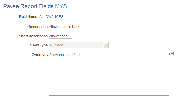

Use the Payee Report Fields MYS page (GPMY_PR_FIELDS) to set up report fields.
Data items that are used on a report must first be defined on this page.
Navigation:
This example illustrates the fields and controls on the Payee Report Fields MYS page. You can find definitions for the fields and controls later on this page.
Field or Control |
Description |
Field Name |
Enter a value that uniquely identifies a field that is to be printed on a report. You may use a maximum of 15 characters. |
Description |
Enter a description of the report field. |
Short Description |
Enter a description of the report field. If this field is blank, the system enters the first 10 characters of the Description field. |
Field Type |
Select a data format for the field. The field may be defined as numeric, character, or date, but the process only manages numeric fields. Note: When a field type is selected for a report field, it cannot be altered. |
Comment |
Enter additional information about the field. |

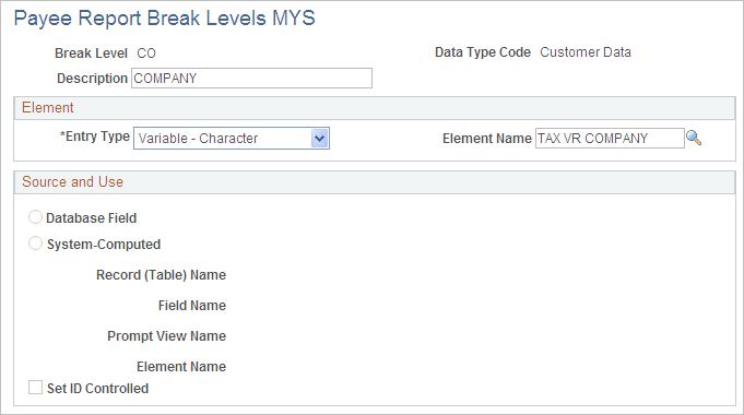

Use the Payee Report Break Levels MYS page (GPMY_PR_BRK_LVLS) to define break levels.
Navigation:
This example illustrates the fields and controls on the Payee Report Break Levels MYS page. You can find definitions for the fields and controls later on this page.
Field or Control |
Description |
Break Level |
Enter a number that identifies the break level code. |
Data Type |
Select the data type. Values are: System Data: A delivered break level. Customer Data: All other break levels. |
Element
Field or Control |
Description |
Entry Type |
Select the entry type of the element that you associate with the break level. Values are System Element - Character and Variable - Character. |
Element Name |
Select the system element of variable that you associate with the break level. For example, if you define pay group as the break level, select the GP PAYGROUP element. Note: Any element that is selected must be resolved and stored. |
Source and Use
If you select a system element, information that is contained on the Source and Use page of GP_PIN appears in this group box.

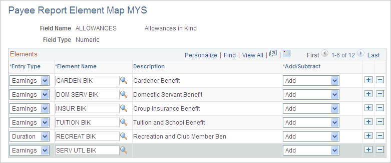

Use the Payee Report Element Map MYS page (GPMY_PR_ELEM_MAP) to define the elements that are to be reported.
Navigation:
This example illustrates the fields and controls on the Payee Report Element Map MYS page. You can find definitions for the fields and controls later on this page.
Field or Control |
Description |
Entry Type |
Select the type of element that is to be mapped to the Report field. This value changes depending on the field type. |
Element Name |
Enter the name of the element that is to be mapped to the Report field. |
Add/Subtract |
Indicate whether the element is added to or subtracted from the result of the Report field. |

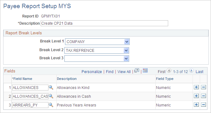

Use the Payee Report Setup MYS page (GPMY_PR_SETUP) to define reports.
Navigation:
This example illustrates the fields and controls on the Payee Report Setup MYS page . You can find definitions for the fields and controls later on this page.
Field or Control |
Description |
Report ID |
Enter the name of the Structured Query Report. |
Report Break Levels |
Select the break levels for the report. |
Fields |
Enter the report fields that are to be used in the report. |
