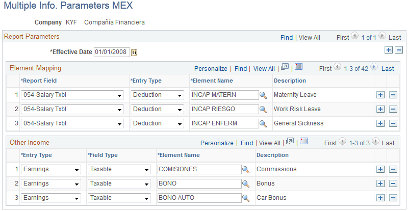

Use the Multiple Info. Parameters MEX page (GPMX_ANNL) to define multiple information report parameters for a company.
Navigation:
This example illustrates the fields and controls on the Multiple Info. Parameters MEX page. You can find definitions for the fields and controls later on this page.
Element Mapping
Field or Control |
Description |
Report Field |
Select the field on the Multiple Information report to which the element will be mapped. |
Entry Type |
Define the entry type for the element. Values are Accumulator, Deduction, and Earnings. |
Element Name |
Select the element which will map to the Multiple Information report. |
Other Income
Other Income field values are for any other earnings or deduction that don't have a specific row defined in the Element Mapping section.
Field or Control |
Description |
Entry Type |
Define the entry type for the element. Values are Deduction and Earnings. |
Field Type |
Select Taxable or NonTaxable for the earnings or deduction entry type. |
Element Name |
