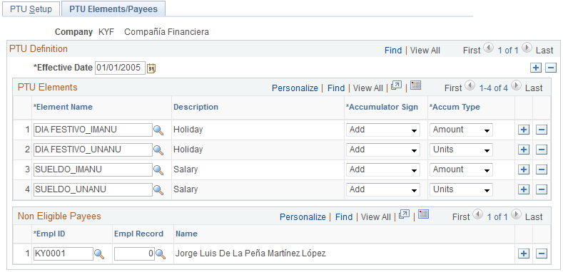

Use the PTU Elements/Payees page (GPMX_PTU_COMPANY2) to identify the PTU elements and payees.
Identify the earnings and deductions used for profit sharing, assign profit sharing elements to accumulators, and exclude ineligible employees from the profit sharing process.
Navigation:
This example illustrates the fields and controls on the PTU Elements/Payees page. You can find definitions for the fields and controls later on this page.
PTU Elements
Field or Control |
Description |
Element Name |
Enter the earnings and deduction accumulators to include in the PTU process. |
Accumulator Sign |
Select an accumulator sign. Values are: Add: Adds the earnings and deduction accumulators specified in theElement Name field to the PTU base. Subtract: Subtracts the earnings and deduction accumulators specified in theElement Name field from the PTU base. |
Acum Type (accumulator type) |
For each element that you specify in the Element Name field, select Amount or Units. Important! When you define an earnings element that you know must be included in the PTU process, create year-to-date accumulators storing both amounts and units for that element. (You can set up an accumulator for units only if the element includes a unit component in its definition.) Otherwise, you will not have the flexibility to accumulate both units and amounts. |
Non Eligible Payees
Enter the employee ID and employee record number for employees who do not qualify for inclusion in the profit sharing process.
