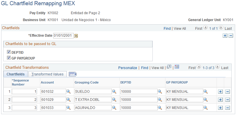

Use the GL Chartfield Remapping MEX page (GPMX_GL_MAP) to set up GL ChartField parameters that enable you to remap ChartFields after you run the initial Calculate process.
You can configure and maintain GL remapping data. Enables you to set up different levels of ChartFields based on GL groupings codes or accounts.

This example illustrates the fields and controls on the GL Chartfield Remapping MEX page. You can find definitions for the fields and controls later on this page.
Chartfields
ChartFields represent attributes of a payee, such as department, pay group, company, employee ID, etcetera. When you send a payee's earnings, deductions, or accumulator amounts to General Ledger, you can also transmit the values that are associated with your specific combination of ChartFields for the payee.
Field or Control |
Description |
Chartfields to be passed to GL |
A field appears for each ChartField that you set up on the Mapping page in Global Payroll. Use the specific ChartFields check boxes to prevent the system from sending particular ChartFields to the GL. During mapping, ChartFields can be used to cost to different account codes. You can then elect not to send the ChartFields to the GL and only send the values to the accounts. When integrating Global Payroll with General Ledger, you can remap ChartField values to a business unit's GL account numbers. To enter the new, remapped ChartField value, use the Transformed Values tab. |
Chartfield Transformations
The default ChartFields values appear in the fields on the ChartFields tab. To remap the default settings, select the new values on the Transformed Values tab.
Chartfields and Transformed Values
Field or Control |
Description |
Account |
Displays the GL account number to which your ChartFields and grouping codes will map. |
Grouping Code |
Select the code to map to the GL account. This is the grouping code for the elements that are included in the GL transfer. A grouping comprises entry types of earnings, deductions, or segment accumulators. Elements must be in groups before they can be processed by General Ledger. Instead of entering earnings individually, you bundle them into one accumulator and create a grouping code for that accumulator. |
