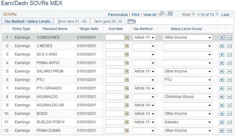

Use the Earn/Dedn SOVRs MEX (Earnings/Deductions SOVRs MEX) page (GPMX_ERNDED_SOVR) to set up SOVRs at the earnings and deduction level for variables used in key calculations.
Navigation:
This example illustrates the fields and controls on the Earn/Dedn SOVRs MEX page. You can find definitions for the fields and controls later on this page.
Tax Method/Salary Levels Tab
Field or Control |
Description |
Entry Type |
For a Minimum Wage Salary Level report: Define the type of element to include in the report. You can include only earnings or deductions. For tax method selection: Define the type of element to which you want to apply a tax method using the Tax Method field. You can include only earnings or deductions. |
Element Name |
For a Salary Level report: Enter the name of the earnings or deductions element to include in the Minimum Wage Salary Levels report (report GPMXAA01). For tax method selection: Enter the name of the earnings or deductions to which you want to apply a tax method using the Tax Method field. |
Begin Date |
Enter the begin date of the supporting element override. |
End Date |
Enter the end date of the supporting element override. |
Tax Method |
Define the tax method to apply to each earnings and deduction identified in the Entry Type andElement Name fields. |
Salary Level Group |
For a Minimum Wage Salary Level report, specify the salary level group in which you want to include the earnings or deductions identified in the Element Name field. |
