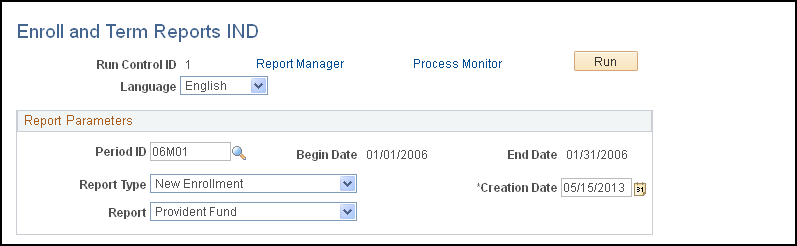

Use the Enroll and Term Reports IND page (GPIN_PR_GPINPY01) to generate enrollment and termination reports.
Navigation:
This example illustrates the fields and controls on the Enroll and Term Reports IND page. You can find definitions for the fields and controls later on this page.
Field or Control |
Description |
Period ID |
Select the period ID that identifies the pay period to be used for the report. When you enter a value in this field, the associated begin date and end date appear. |
Report Type |
Select whether to generate a new enrollment or termination report. |
Report |
Select whether to generate an ESI or provident fund report. |

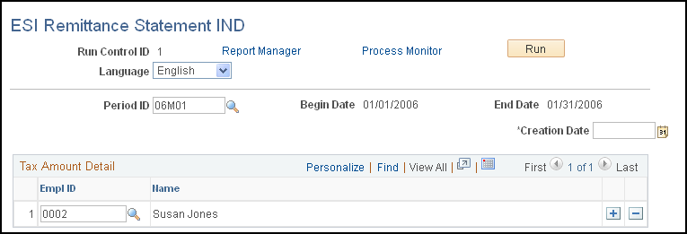

Use the ESI Remittance Statement IND (employee state insurance remittance statement IND) page (GPIN_PR_RC) to generate ESI remittance statement reports.
Navigation:
This example illustrates the fields and controls on the ESI Remittance Statement IND page. You can find definitions for the fields and controls later on this page.
Field or Control |
Description |
Period ID |

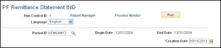

Use the PF Remittance Statement IND (provident fund remittance statement IND) page (GPIN_PR_RC) to generate provident fund remittance statement reports.
Navigation:

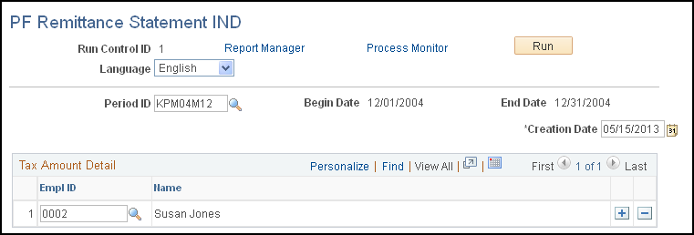

This example illustrates the fields and controls on the PF Remittance Statement IND page (1 of 2). You can find definitions for the fields and controls later on this page.
This example illustrates the fields and controls on the PF Remittance Statement IND page (2 of 2). You can find definitions for the fields and controls later on this page.
Field or Control |
Description |
Period ID |
Payee Sort Option |

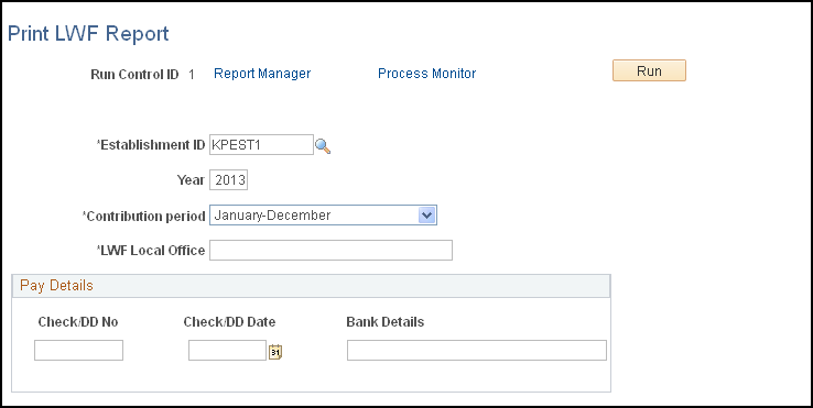

Use the Print LWF Report (print labour welfare fund report) page (GPIN_FORMLWF_RC) to run LWF form A.
Navigation:
This example illustrates the fields and controls on the Print LWF Report page. You can find definitions for the fields and controls later on this page.
This report prints the contribution made by the employer and employee toward LWF.
