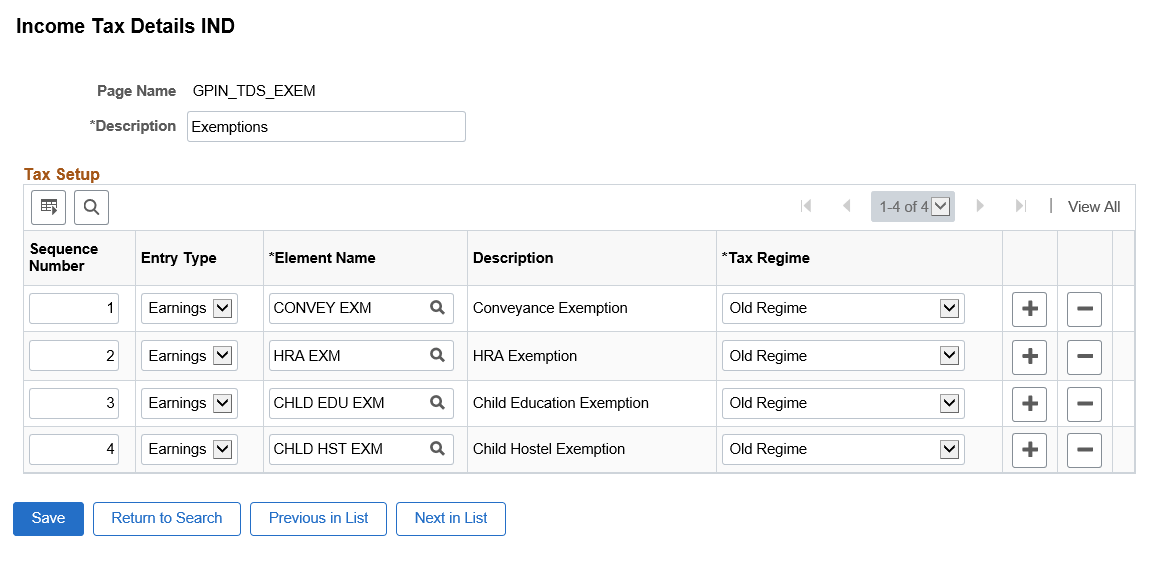

Use the Tax Setup – Exemptions page (GPIN_TDS_EXEM) to set up tax exemptions.
Navigation:
Setup HCM > Product Related > Global Payroll & Absence Mgmt > Taxes > Income Tax Details IND > Exemptions
This example illustrates the fields and controls on the Tax Setup – Exemptions page. You can find definitions for the fields and controls later on this page.
Tax setup exemption page
Note: See field descriptions under the Common Elements heading at the beginning of this section.

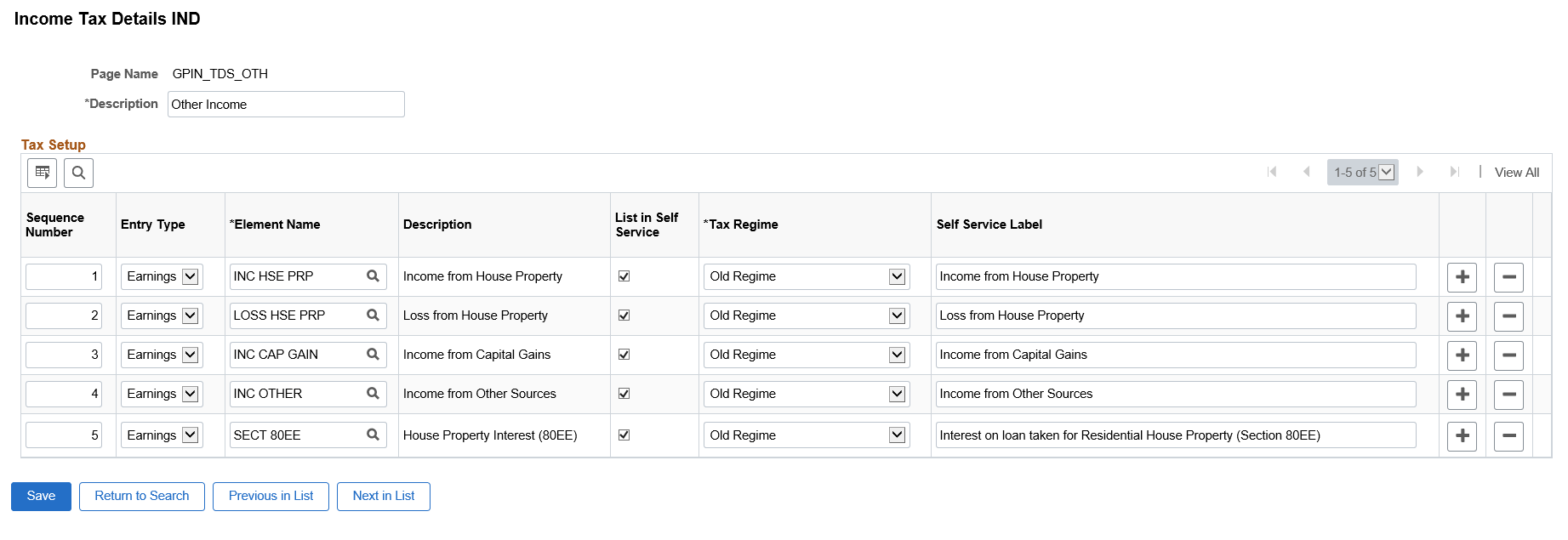

Use the Tax Setup – Other Income page (GPIN_TDS_OTH) to set up other income information.
In addition you can enable self service functionality using this page.
Navigation:
Setup HCM > Product Related > Global Payroll & Absence Mgmt > Taxes > Income Tax Details IND > Other Income
This example illustrates the fields and controls on the Tax Setup – Other Income page. You can find definitions for the fields and controls later on this page.
Tax setup other income page

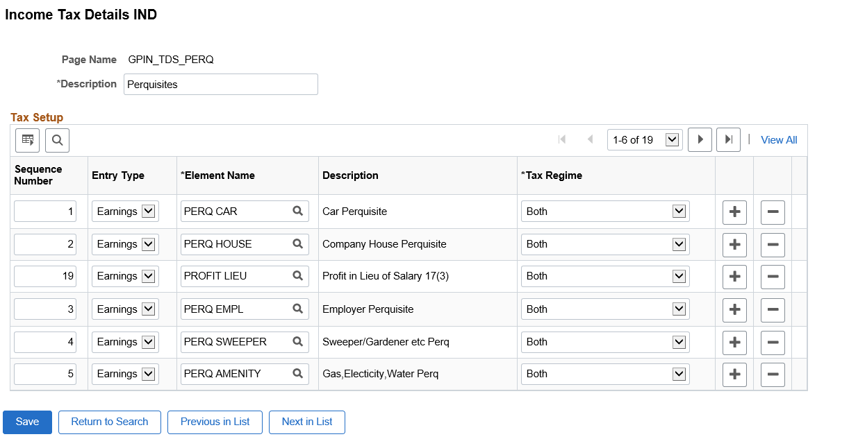

Use the Tax Setup – Perquisites page (GPIN_TDS_PERQ) to set up information for perquisites.
Navigation:
Setup HCM > Product Related > Global Payroll & Absence Mgmt > Taxes > Income Tax Details IND > Perquisites
This example illustrates the fields and controls on the Tax Setup – Perquisites page. You can find definitions for the fields and controls later on this page.
Tax setup Perquisites page
