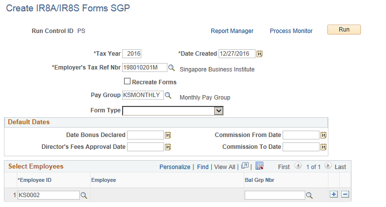

Use the Create IR8A/IR8S Forms SGP page (GPSG_RC_IR8A_CR) to enter run control options for the IR8A Creation process.
Navigation:
This example illustrates the fields and controls on the Create IR8A/IR8S Forms SGP page.
Field or Control |
Description |
Tax Year |
While creating an amendment record, note that the amendment can be made only for two previous tax years. If the year you enter is more than two previous tax years, system shows an error message. |
Recreate Forms |
Select this check box if you want to recreate the date (previously created) for any forms. The system checks the status before attempting to recreate. If the status is awaiting issue (to the employee), the system saves any manual entries contributing to the existing form and creates another form. If the status is issued, the system ignores the recreate instruction. The manually entered fields are not affected by recreating, and the records with a status of issued are not updated by a recreate run. When recreating data, all amount fields on the existing IR8A data are reset to zeros. |
Form Type |
Select from the following:
Note: If you are creating an amendment record, select the form type as ‘Amendment’. |
Default Dates
Field or Control |
Description |
Date Bonus Declared |
Enter the date on which the non-contractual payment is declared payable. Non-contractual bonuses are due and payable at the discretion of the employer and are regarded as the employee's income on the date that the employer decides that the bonuses are payable. For example, you should declare in 2006 to pay a non-contractual bonus in 2007, for the year ending December 31, 2006. Note: If the bonus or directors fees dates are not entered on the run control, the payment date is used. However, this is not the case for commissions. If commission dates aren't entered, they are left blank. |
Director's Fees Approval Date |
Enter the date that the payment of director's fees is approved. Director's fees are regarded as paid to the director on the date on which the fees are voted for and approved at a company's annual general meeting of that calendar year. (Director's fees do not require a CPF contribution). |
Commission From Date and Commission To Date |
Enter the period on which the commission is paid in the tax year. |
