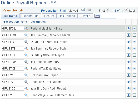

Use the Define Payroll Reports USA page (GPUS_RPT_SETUP) to define parameters used by the payroll report jobs.
Navigation:
This example illustrates the fields and controls on the Define Payroll Reports USA page.
Job Name
Field or Control |
Description |
Process Job Name |
Enter the job name for the report. |
