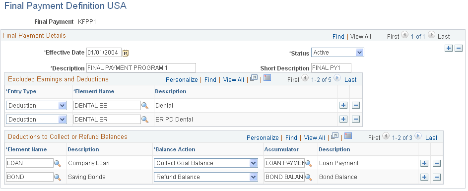

Use the Final Payment Definition USA page (GPUS_FPMT) to enter details about what elements to pay when a payee is terminated.
Navigation:
This example illustrates the fields and controls on the Final Payment Definition USA page.
Excluded Earnings and Deductions
In this group box, indicate which earnings and deductions not to process.
Field or Control |
Description |
Entry Type |
Specify the type of element to exclude from the payroll process. Valid values are Earnings and Deduction. |
Element Name |
Enter the name of the element to exclude from the payroll process. |
Note: If an element is listed in this group box and positive input exists, positive input takes priority.
Deductions to Collect or Refund Balances
In this group box, identify the deductions that have goal balances that you want to collect or refund.
Field or Control |
Description |
Element Name |
Enter the name of the deduction element with the balance to collect or refund. Note: Any deduction can be entered, whether it has a goal balance or not. If a deduction is entered with no goal balance, then no special processing will occur for that element. If an element is entered and positive input exists, positive input takes priority. |
Balance Action |
Select the balance action. Valid values are:
Accumulator |
Specify the accumulator that holds the balance to collect or refund. |

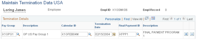

Use the Maintain Termination Data USA page (GPUS_FPMT_PYE) to assign a final payment definition to a payee.
Navigation:
This example illustrates the fields and controls on the Maintain Termination Data USA page.
Field or Control |
Description |
Pay Group |
Identify the pay group containing the payee to whom to are assigning the final payment definition. |
Calendar ID |
Identify the calendar you are using to process the final payment. |
Termination Date |
Enter the termination date (final payment date). Note: This component does not update the payee's JOB record with termination data. The termination must be defined separately in the JOB record. |
Final Payment ID |
Identify the final payment definition to assign to the payee. Final payment definitions are created on the Final Payment Definition page. |
