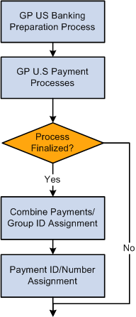

This diagram illustrates the PeopleSoft Global Payroll for United States payment preparation process flow:
This diagram illustrates the PeopleSoft Global Payroll for United States payment preparation process flow.
Payment preparation requires running several processes. Each process has a unique purpose in preparing payments for banking and payment.

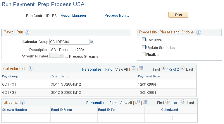

Use the Run Payment Prep Process USA page (GPUS_PMT_PREPARE) to run the banking payment preparation process for PeopleSoft Global Payroll for United States.
Navigation:
This example illustrates the fields and controls on the Run Payment Prep Process USA page.
Payroll Run
Field or Control |
Description |
Calendar Group |
Select the calendar group on which to run the process. The system processes any items (segments) that are approved or finalized by the payroll process. |
Stream Number |
If the Process Streams check box is selected and you select Calculate in the Processing Phases and Options group box, you must select the stream number to process. Each stream number represents a predefined range of payees. |
Process Streams |
The Process Streams check box is selected automatically if you select the stream processing option when defining the calendar group. |
Field or Control |
Description |
Calculate |
Select to have the system create the payment file by matching the finalized results from the payroll process with information you defined in the banking setup. You can run the Calculate step repeatedly until you finalize the banking process. |
Update Statistics |
Select to have the banking system generate statistics to help the data administrator fine-tune system performance. |
Finalize |
After everything is calculated, select Finalize. (If you used stream processing for the Calculate phase, the system finalizes all streams for the calendar group simultaneously.) Note: If you're not using streams, you can select Calculate and Finalize at the same time. Note: Payment numbers are generated only during the Finalize process. |
Calendar List
After you run the Calculate phase, this group box displays information for each calendar in the calendar run.
Streams
This group box displays all streams associated with the calendar group.

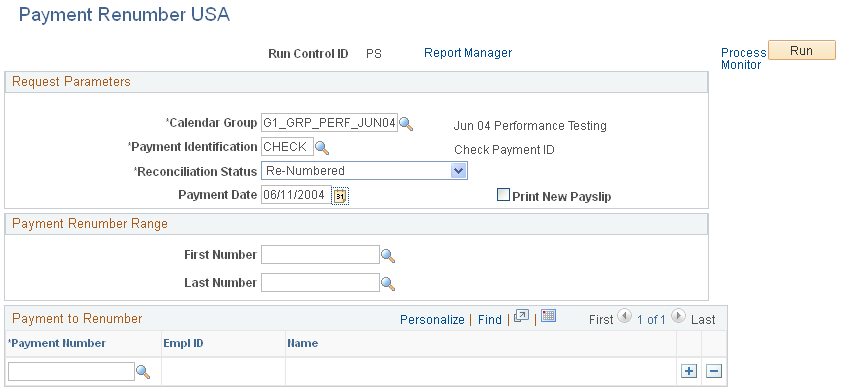

Use the Payment Renumber USA page (GPUS_PYMT_RNB) to run the payment renumber process.
Navigation:
This example illustrates the fields and controls on the Payment Renumber USA page.
Use this page to run the payment renumbering process. For example, if a payee asks for a replacement of his or her payment and cannot find the original, you can run the payment renumbering process to issue a new payment with a new number.
Request Parameters
Field or Control |
Description |
Calendar Group |
Payment Identification |
Enter the payment ID that needs to be renumbered. |
Reconciliation Status |
Indicate the reconciliation status for the payments being renumbered. |
Payment Date |
Enter the payment date for the renumbered payments. |
Print New Payslip |
Select if you need to print a new payslip for the payments being renumbered. |
Payment Renumber Range
Field or Control |
Description |
First Number and Last Number |
If a series of checks need renumbering, enter the first and the last number in this series. |
Payment to Renumber
Field or Control |
Description |
Payment Number |
If just a few checks need renumbering, enter the payment numbers in the Payment to Renumber section. |
