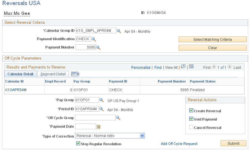

Use the Reversals USA page (GPUS_REVERSAL) to retrieve payments to be reversed or submit reversal requests.
Navigation:
Note: When you save this page, a component interface populates the Correction Request Detail page in the Off Cycle Requests (GP_OFFCYCLE_SETUP) component. In addition, the component interface updates the payment processing status from Finalized to Void.
This example illustrates the fields and controls on the Reversals USA page.
Field or Control |
Description |
Calendar Group ID |
Enter the Calendar Group ID corresponding to the payment that you want to reverse. |
Payment Identification |
Enter a payment ID. Valid values are all payment IDs in the Payment ID Definition table. |
Payment Number |
Enter the number of the payment being reversed. |
Select Matching Criteria |
Select to populate the fields on the Calendar and Segment Detail tabs with detailed information about the calendar associated with the calendar group ID displayed at the top of the page. |
Clear |
Select to clear the fields on the Calendar and Segment Detail tabs. |
Pay Group |
The pay group is supplied by default from the calendar retrieved when you select the Retrieve Calendars button. The pay group is the same for the on-cycle and off-cycle calendars. |
Period ID |
Enter the ID of the target period. This is typically the period in which the reversal is processed. It is the period in which balance accumulators are updated. Note: The target period selection is limited to periods associated with calendars that are defined for this particular pay group. |
Offcycle Group |
Select the off-cycle group for which you want to process the reversal. The groups that are available for selection are those defined on the Off Cycle Requests component (GP_OFFCYCLE_SETUP). |
Payment Date |
Supplied by default from the off-cycle group, but it can be overridden for individual payments. |
Type of Correction |
Select the type of reversal that you want to use to process the selected calendars. Valid values are:
Note: If you want to reverse and replace a check because a payee never received payment, select Replacement in the Correction Type field on the Correction Request Detail page and enter positive input for the correct amount. |
Stop Regular Resolution |
Select to stop the resolution of all elements on the process list except those that you specify for the reversal. |
Reversal Actions |
The Create Reversal and Void Payment check boxes are selected by default. When you submit a reversal with these check boxes selected, the system creates a row on the Corrections page and changes the status of the payment to Void. If you submit a reversal with the Void Payment check box deselected, the system creates a row on the Corrections page, but does not update the status of the payment. In this case, the Cancel Reversal check box is available when you return to the Reversals USA page for the same payment. If you select the Cancel Reversal check box and select the Submit button, the system deletes the associated row on the Corrections page. |
Add Off Cycle Request |
Select the link to go to the Off Cycle Requests component (GP_OFFCYCLE_SETUP), where you can define a request for a correction if you have not already done so. |
