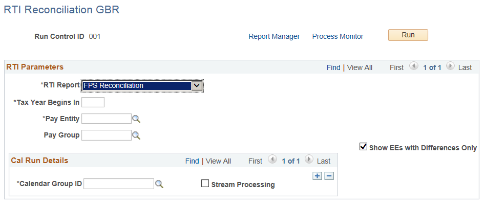

This example illustrates the fields and controls on the RTI Reconciliation GBR page for generating the FPS Reconciliation report.
Field or Control |
Description |
RTI Report |
Select the FPS Reconciliation report type from the following options:
Tax Year Begins In |
The year in which the Fiscal Year begins. Example: For FY 2013-14, the value will be 2013. |
Pay Entity |
Select the Pay Entity for whom the user wants to run the report. |
Pay Group |
Select the Pay Group for which the user wants to run the report. Note: This field is visible only if FPS Reconciliation is selected in the RTI Report field. |
Calendar Group ID |
Select the Calendar Run ID for which the user wants to run the report. User can run the report for multiple Calendar Run IDs at the same time. Note: This field is visible only if FPS Reconciliation is selected in the RTI Report field. |
Stream Processing |
Select the check box if stream processing was used during the payroll process. This field is visible only if FPS Reconciliation is selected in the RTI Report field. Note: On selecting the Stream processing check box, a new field is displayed to select the stream number to process. |
Show EEs with Differences Only |
Select the check box if you want the report to contain only the employees with differences. Leave the check box blank if you want to include all the employees in the report. By default, this check box is selected. Note: This field is visible only if FPS Reconciliation or EPS Reconciliation is selected in the RTI Report field. |
Run |
Click the Run button to generate FPS Reconciliation Reports. You can view the generated report using the Report Manager link. |

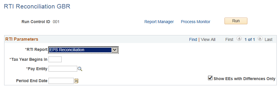

This example illustrates the fields and controls on the RTI Reconciliation GBR page for generating the EPS Reconciliation report.
Field or Control |
Description |
RTI Report |
Select the EPS Reconciliation report type from the following options:
Pay Entity |
Period End Date |
The Period End Date for which the user wants to run the report. Note: This field is visible only if EPS Reconciliation or Payroll Reconciliation is selected in the RTI Report field. |
Run |
Click the Run button to generate EPS Reconciliation Reports. You can view the generated report using the Report Manager link. |

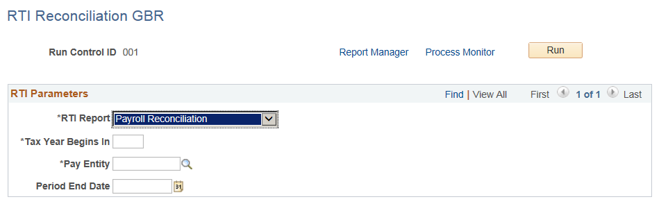

This example illustrates the fields and controls on the RTI Reconciliation GBR page for generating the Payroll Reconciliation report.
Field or Control |
Description |
RTI Report |
Select the Payroll Reconciliation report type from the following options:
Pay Entity |
Period End Date |
Run |
Click the Run button to generate Payroll Reconciliation Reports. You can view the generated report using the Report Manager link. |
