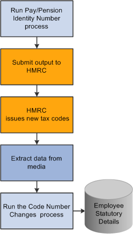

At the end of every tax year, HMRC calculates employees' tax codes for the next tax year.
This diagram illustrates how the Pay/Pension Numbers and Code Number Changes processes enable you to submit information to HMRC and receive updated tax codes electronically:
The Code Number Changes process is discussed in an earlier topic.
