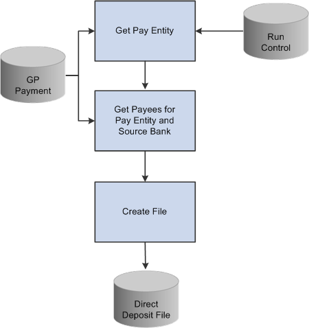

This diagram shows the Create Payment EFT File process:
This diagram shows the Create Payment EFT File process.
