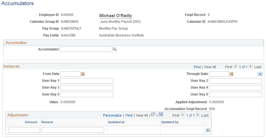

Use the Accumulators page (GP_ACM_USER_ADJ) to adjust an accumulator balance for a given payee in a finalized calendar group.

This example illustrates the fields and controls on the Accumulators page.

Accumulator
Field or Control |
Description |
Accumulator |
Select the accumulator to adjust. Once selected, the system displays the accumulator's description to the right of this field and populates the Instances group box with information from the result tables. If no results are returned, the accumulator has no recorded balance for the identified employee record and calendar. |
Instances
This group box displays the recorded balance, if any, for the selected employee record and calendar. You can enter new instances to add to the result tables at the end of the calendar ID that appears.
Field or Control |
Description |
From Date and Through Date |
The begin and end dates for the accumulator period. |
User Key |
The user keys that are associated with the accumulator. |
Value |
The value of the accumulator for the employee (and employee record) at the end of that calendar ID period. |

Applied Adjustment |
The sum of adjustments that have been made to this accumulator instance. When you click Save, this number is updated to reflect all accumulator adjustments that are currently entered in the Adjustments group box. |
Adjustments
Field or Control |
Description |
Amount |
Enter the adjustment amount, either positive or negative. |
Reason |
Enter the reason for the adjustment |
Updated At and Updated by |
The system populates these fields when you save the page and displays them when you query adjustments. |
Note: You can add new instances and adjust accumulators, but you cannot delete entered data. All adjustments remain in the system for an audit trail. To reverse a prior adjustment, enter a row with an offsetting or negative value.
