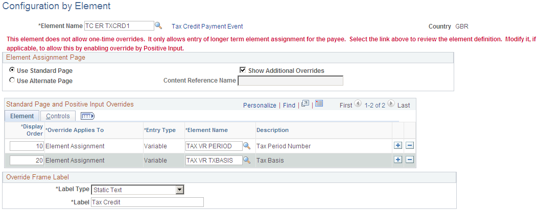

Use the Configuration by Element page (GP_ED_SETUP) to:
Define your own label for the Supporting Element Overrides group box.
Specify standard page and positive input overrides.
Navigation:
The label that you define here will appear in the system for elements in the specified element category. It applies to both the Element Detail and the Calendar ID Override page.
You can also use this page to specify standard page and positive input overrides (applies to Element Detail only). Using the Standard Page, you can control whether the group of Additional Overrides field are to be displayed or not. Using a Custom Page you specify what page you want displayed and any additional search criteria required to transfer to this page. Enter standard element override specifications while indicating if you want the Supporting Element Override fields to appear the same on the Element Detail or the Positive Input - Details pages, or both.
The Element level configuration may be done for an Earning or Deduction that allows overrides at the Payee (Element Assignment) level, or the Positive Input (Calendar ID Overrides) level, but not both.
This topic shows the Configuration by Element page as it will be rendered for:
Payee level overrides only.
Positive Input level overrides only.
Payee Level Overrides Only
In the case of an element that allows overrides only at the Payee level (and not at the Positive Input level) the Configuration by Element page appears as follows:
This example illustrates the fields and controls on the Configuration By Element page: Payee Level Overrides (1 of 2).
This example illustrates the fields and controls on the Configuration By Element page: Positive Input Level Overrides (2 of 2), Controls tab.
Element Assignment Page
Use fields in this group box to use the standard page or to point an entirely new component to replace the Element Detail page or the Positive Input - Details page. These give you additional flexibility to define fields, page labels, prompts, and other page elements.
Field or Control |
Description |
Use Standard Page |
Select if you want to configure, but not replace, the element override page for a specific element. |
Use Alternate Page |
Select to designate an alternate page and component to replace the Element Detail page and the Positive Input - Details page for a specific element. If you select this option, you must enter the portal definition of the alternate component in the Content Reference Name field. Note: You must create the alternate page, component and portal content reference prior to selecting it on this page. See PeopleTools: Application Designer Developer's Guide product documentation. |
Content Reference Name |
Enter the name of the content reference you have created to replace the standard Element Detail page and the Positive Input - Details page. This field is only available if you have indicated Use Alternate Page. |
Show Additional Overrides |
Select to display the existing fields in the Additional Overrides group box on the Element Detail page and the Positive Input - Details page. This field is only relevant when Use Standard Page is indicated. |

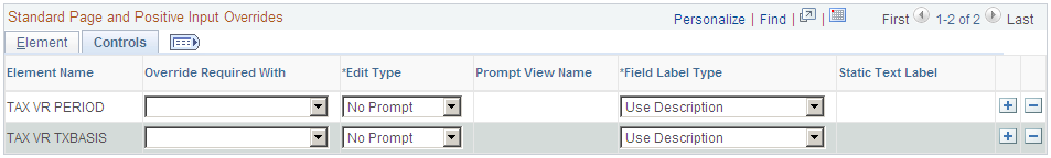

Standard Page and Positive Input Overrides
Use the fields in the Element Assignment Page Overrides group box to specify the same element override modification rules for the earning/deduction assignment entries. Specifically, use the Element tab and the Controls tab to define:
The supporting elements you want users to be able to override on the Element Detail page.
The order in which supporting elements appear on the Element Detail page.
Prompts and required fields.
Field or Control |
Description |
Display Order |
Enter a sequence number to define the order in which the override elements appear on the Element Detail page. Note: Override elements will be listed in ascending display order. |
Element Name |
Enter the name of the element corresponding to the specified entry type. Only elements that are set up to allow overrides at the payee level are included in the prompt. In addition, no monetary type variable elements are allowed. |
Override required with |
Valid values are:
Edit Type |
Use this field to associate prompt table edits with the supporting element specified in the Element Name field. Enter one of the following values:
Field Label Type |
Select one of the following options:
Field Label |
When Field Label Type or Static Text is selected, you must enter an alphanumeric string between 1 and 30 characters in length. This text will be used as Label when presenting this field on the Element Detail and/or Calendar ID Override page. |
Override Frame Label
Use the following fields to define a descriptive label to replace the generic Supporting Element Overrides group box label on the Element Detail page.
Note: The system references these values for delivered or standard supporting element override components.
Field or Control |
Description |
Label Type |
Message Set |
Select the message set containing the label you want to display on the Element Detail page. This field becomes available when you select Message Catalog as the option for field Label Type. |
Message Number |
Select the message number corresponding to the label you want to display on the Element Detail page. This field becomes available when you select Message Catalog as the option for field Label Type. |
Label |
Enter the label you want to display on the Element Detail page. This field becomes available when you select Static Text as the option for field Label Type. |

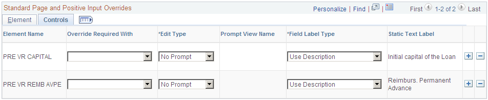

Positive Input Level Overrides Only
In the case of an element that allows overrides only at the Positive Input level (and not at the Payee level) the Configuration by Element page appears as follows.
This example illustrates the fields and controls on the Configuration By Element page for Positive Input Level Overrides (1 of 2).
This example illustrates the fields and controls on the Configuration By Element page: Positive Input Level Overrides (2 of 2).
Field or Control |
Description |
Display Order |
Enter a sequence number to define the order in which the override elements appear on the Positive Input - Details page. Note: Override elements will be listed in ascending display order. |
Element Entry Type |
Enter the kind of supporting elements for which you want to enter overrides on the Positive Input - Details page. Select from the following options:
Element Name |
Enter the name of the element. Only elements that are set up to allow overrides at the payee level are included in the prompt. |
Valid values are:
Edit Type |
Field Label Type |
Note: The element will be presented on the Element Assignment Detail or Calendar Override page using the elements description or name as label. |
Field Label |
When Field Label Type of Static Text is selected, you must enter an alphanumeric string between 1 and 30 characters in length. This text will be used as Label when presenting this field on the Element Detail and/or Calendar ID Override page. |
