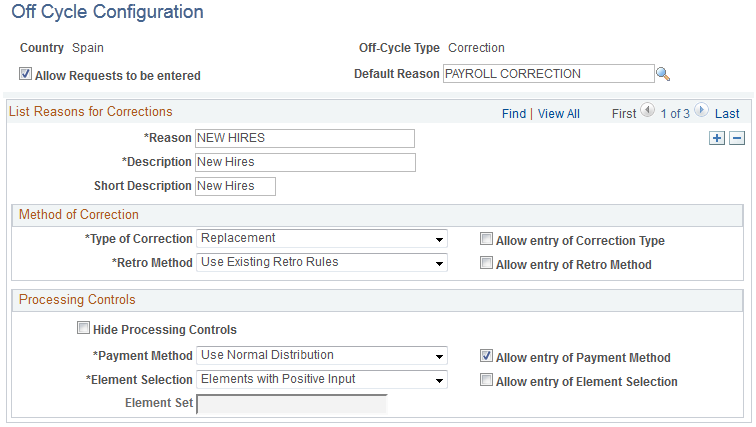

Use the Off Cycle Configuration page (GP_OC_SETUP) to define Global Payroll configurations, specific to country and type of transaction, that configure the Off Cycle Request page.
Navigation:
This example illustrates the fields and controls on the Off Cycle Configuration page.

Transaction Type and Reasons
Field or Control |
Description |
Country |
Displays the country for which you are configuring the off cycle request page. |
Off-Cycle Type |
Select the off cycle transaction type for which you want to configure the request page. Values are Additional payment, Advance, Correction, and Manual payment. |
Allow Requests to be entered |
Select to allow off cycle requests to be entered for specific off cycle types for a specific country. The default is selected. If this check box is deselected, you will not be able to enter any off cycle requests for the type and country that is specified. |
Default Reason |
Enter a default reason that will populate the off cycle request. This reason can be overridden when the request is being created. |

Method of Correction
This section is available for entry only when the Off Cycle Type is Correction.
Field or Control |
Description |
Type of Correction |
Select the types of correction that are valid. Values are:
Allow entry of Correction Type |
Select if you want the user of the off cycle request to be able to enter a correction type. |
Retro Method |
Select a retro method to use with the type of correction that is selected. Values are Forced Corrective and Use Existing Retro Rules. |
Allow entry of Retro Method |
Select if you want the user of the off cycle request to be able to enter a retro method. |
Processing Controls
Field or Control |
Description |
Hide Processing Controls |
Select to hide all processing controls on the Off Cycle Request page. |
Allow entry of Payment Keys |
Select if you want the user of the off cycle request to be able to enter payment keys. |
Run Type |
Enter the run type to use for this off cycle type. |
Allow entry of Run Type |
Select if you want the user of the off cycle request to be able to enter a run type. |
Payment Method |
Select the payment method to use for the off cycle type and reason. Values are Cash, Check, Postal Order, Pay Primary Account Only, and Use Normal Distribution. |
Allow entry of Payment Method |
Select if you want the user of the off cycle request to be able to enter a payment method. |
Allow Partial Period Advances |
This option is available only when the off cycle type is advance payment. Select if you will advance part of a pay period. |
Element Selection |
Select the element selection for the off cycle request. Values are All, Elements with Positive Input, and Limited Element Set. |
Allow entry of Element Selection |
Select if you want the user of the off cycle request to be able to enter an element selection. |
