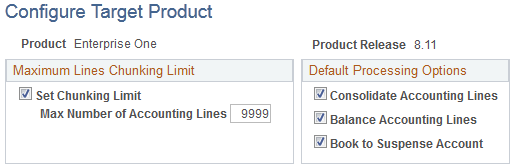

Use the Configure Target Product page (HPIP_CONFIG_PRD) to assign processing defaults for the target product.
Navigation:
This example illustrates the fields and controls on the Configure Target Product page.
Note: The data on this page is delivered as system data; generally, you should not modify this data.
Maximum Lines Chunking Limit
Field or Control |
Description |
Set Chunking Limit |
Select if you want the system to chunk the data when the number of accounting lines exceeds the maximum of the target product. |
Max Number of Accounting Lines (maximum number of accounting lines) |
This field is available for entry if you select Set Chunking Limit. Enter the maximum number of accounting lines that the target product can accept. |

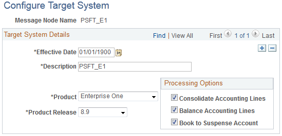

Use the Configure Target System page (HPIP_TGT_SYS_GL) to select the target product for the target and update the processing options for the target product.
Navigation:
This example illustrates the fields and controls on the Configure Target System page.
When you access the page, select the PeopleSoft Integration Broker node that you defined for the integration with EnterpriseOne. The node represents the target system.
Target System Details
The default processing options that you selected on the Configure Target Product page are the default values on this page. You can update the processing options here. You can also override the processing options on the process run control page when you post the accounting lines.
Field or Control |
Description |
Product |
Select EnterpriseOne as the target general ledger product to which payroll data is to be posted on this target system. |
Product Release |
Select the release number of the product. |
