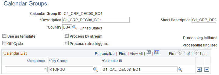

Use the Calendar Groups page (GP_CALENDAR_RUN) to define a group of calendars to process together.
Calendars are processed in the order listed.

This example illustrates the fields and controls on the Calendar Groups page.
Note: After processing begins for an on-cycle run, you should not edit the fields on the Calendar Groups page. To modify this page, cancel the pay run.

Calendar List
List the calendars to process together. The number that you enter in the Sequence field determines the calendar processing order. This grid is hidden when you select the Off cycle check box.
