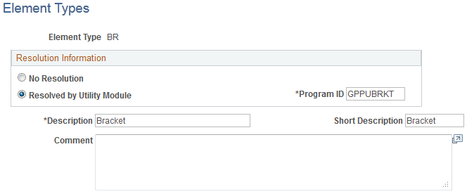

Use the Element Types page (GP_PIN_TYPE) to define element types, such as arrays, brackets, and earnings.
You can also define the program ID that's used to resolve each element.

This example illustrates the fields and controls on the Element Types page.
Field or Control |
Description |
Element Type |
Displays the element type value that you selected in the entry dialog box. |
Resolution Information
Field or Control |
Description |
No Resolution |
Select if you don't want the element resolved. In this case, the element that is associated with the element type is just a point of reference. For example, a pay group is a collection of elements and never resolves to a value. This option is used in batch processing. The PIN manager checks the element type to determine whether any resolution is needed. |
Resolved by Utility Module |
Select if you want the element that is associated with the element type to be resolved by a utility program that is delivered by PeopleSoft or created by you. |
Program ID |
Select the utility program that is used to resolve each element. Program ID data is delivered by PeopleSoft. When a batch process that is running encounters an array element, the process first looks to see which program should be called to resolve the element. This field provides a link for batch processing between an element type and the utility program that is to be used to resolve that element type. Note: If you selected No Resolution in the Resolution Information group box, this field is unavailable for entry. |
