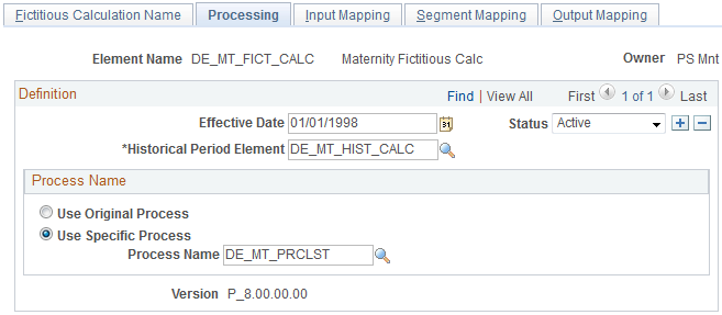

Use the Fictitious Calculations - Processing page (GP_FICT_CALC1) to define the previous period rule for a fictitious calculation that is used to determine the periods for which the fictitious calculation is performed.
You can request that the original process be used or select a different process.
Navigation:
This example illustrates the fields and controls on the Fictitious Calculations - Processing page.
Field or Control |
Description |
Historical Period Element |
Select the element that determines which periods you want to recalculate during the fictitious calculation. The available elements are historical rules specifically created for fictitious calculation. |
Use Original Process |
Select to make the fictitious calculation use the original process. The process won't run the fictitious calculation a second time. |
Use Specific Process |
Select to make the fictitious calculation use a process other than the original process. Select the process that the system should use during this fictitious calculation in the Process Name field. Note: During the fictitious calculation, system element values at the payee level and system-computed elements take on previous period values. |

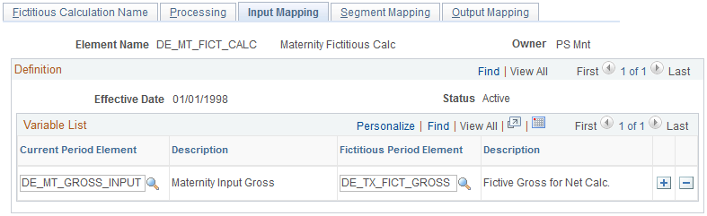

Use the Input Mapping page (GP_FICT_CALC2) to specify elements from the current period for overriding the original values for the selected elements in each of the fictitious periods.
Navigation:
This example illustrates the fields and controls on the Input Mapping page.
Field or Control |
Description |
Current Period Element |
Enter an element whose value is to be passed to the previous period. |
Fictitious Period Element |
Enter a previous period element whose value is to be overridden in the previous period. |

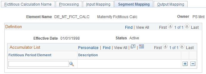

Use the Segment Mapping page (GP_FICT_CALC3) to select the accumulators that are to be forwarded to the next segment.
Navigation:
This example illustrates the fields and controls on the Segment Mapping page.
Field or Control |
Description |
Enter an element whose value is to be forwarded to the next segment. |

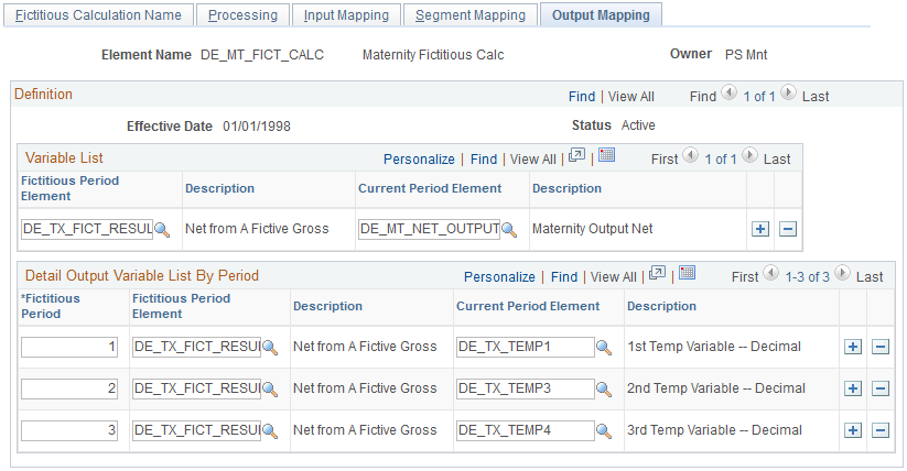

Use the Output Mapping page (GP_FICT_CALC4) to specify elements from the fictitious calculation (summed or averaged) to be passed back to the current period and stored in the current period's elements.
Navigation:
This example illustrates the fields and controls on the Output Mapping page.
Field or Control |
Description |
Enter an element whose sum or average (based on the calculation type of the previous period rule) value is to be passed to the current period. |
Enter an element to store the result of a calculation in a previous period. |
Fictitious Period |
Enter a number to designate the order in which the system shall process the fictitious periods. The lowest number is processed first, and so on. |
Enter an element whose value is to be passed to the current period. |
Enter an element to store the result of the calculation in the previous period. |
