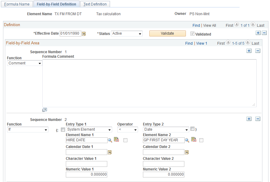

Use the Field-by-Field Definition page (GP_FORMULA1_V2) to define formulas for use in calculations.
View formula definitions.
Navigation:

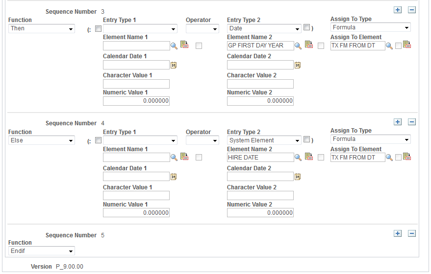

This example illustrates the fields and controls on the Field-by-Field Definition page (1 of 5).
This example illustrates the fields and controls on the Field-by-Field Definition page (2 of 5).
Building Your Formula
Build your formula in the Field-by-Field Area group box, specifying one operation or result in each row.
Field or Control |
Description |
Function |
Select the type of function or qualifier for the formula. Options include And, Average, Comment, Else, Endif, Exit, If, In, Maximum, Minimum, Or, Sum, and Then. |
( (left parenthesis) |
Select to group your formula calculations. Selecting this check box requires that you must select the ) check box. How you group your formula calculations with parentheses can affect the calculation sequence. |
Entry Type 1 or 2, Element 1 or 2, Calendar Date 1 or 2, Character Value 1 or 2, and Numeric Value 1 or 2 |
Select the entry type for the operation. If you select the Character, Cal Date, Date, or Numeric entry type, enter a value in the corresponding Date Value, Numeric Value, or Character Value field. If you select any other entry type, the system prompts for the correct element in the corresponding Element Name field. |
Details |
Click to access the Element Name Attributes page and assign a rounding rule, previous period rule, or element pointer selection to a field that you're using in your formula. The check box to the right of the entry type list is selected if additional information has been entered on the Formula - Field Details page. |
Operator |
Select the operator to perform on the operands that you entered. The following standard operators are available: (none), -, *, /, +, < <=, <>, =, >, and >=. |
) (right parenthesis) |
Select to group your formula calculations. If you select this check box, you must select the ( check box. How you group your formula calculations with parentheses can affect the calculation sequence. |
Assign To Type and Assign To Element |
To assign a value to an element, first select the entry type and then select the element. For example, you might have a formula named BASIC PENSION to define a basic pension amount. This element resolves to 1000 or 1200, depending on how the formula resolves. If you want the element BASIC PENSION to have the value of 1000 or 1200, you must enter BASIC PENSION in Assign To Element in your formula. You can use the BASIC PENSION element as an earning or deduction element, and it will have this value. To use the element feature, you must save a formula with an effective date. |
Note: Under either parenthesis, you can enter multiple sets of parentheses. To do so, use multiple lines. You can enter only one ( or ) per row.

Example: Setting Up a Formula
Using the formula element, you can create elements using mathematical and logical operands, rules, and mathematical formulas.
In this example, you need a simple formula to calculate a pension deduction. The requirements are as follows:
If basic earnings are less than 10,000, the pension deduction is one percent of basic earnings.
If basic earnings are greater than or equal to 10,000, the pension deduction is one percent of the first 10,000 and two percent of the remainder.
The system uses basic earnings for all calculations. The formula should resolve to the amount of the deduction.
Start by turning the calculation into a mathematical formula.
If BASE COMP < 10,000, then
BASE COMP * .10 = PENSION,
else
(10,000 * .01) + ((BASE COMP - 10,000) * .02) = PENSION
Endif
Formulas can often be expressed in multiple ways. To streamline processing, use the simplest version that requires the least processing.
After turning the calculation into a mathematical formula, you enter the formula into the system. If you haven't defined the element and entered the basic descriptions, do so on the Formula Name page. Then, on the Field-by-Field Definition page, define the formula, line by line.
