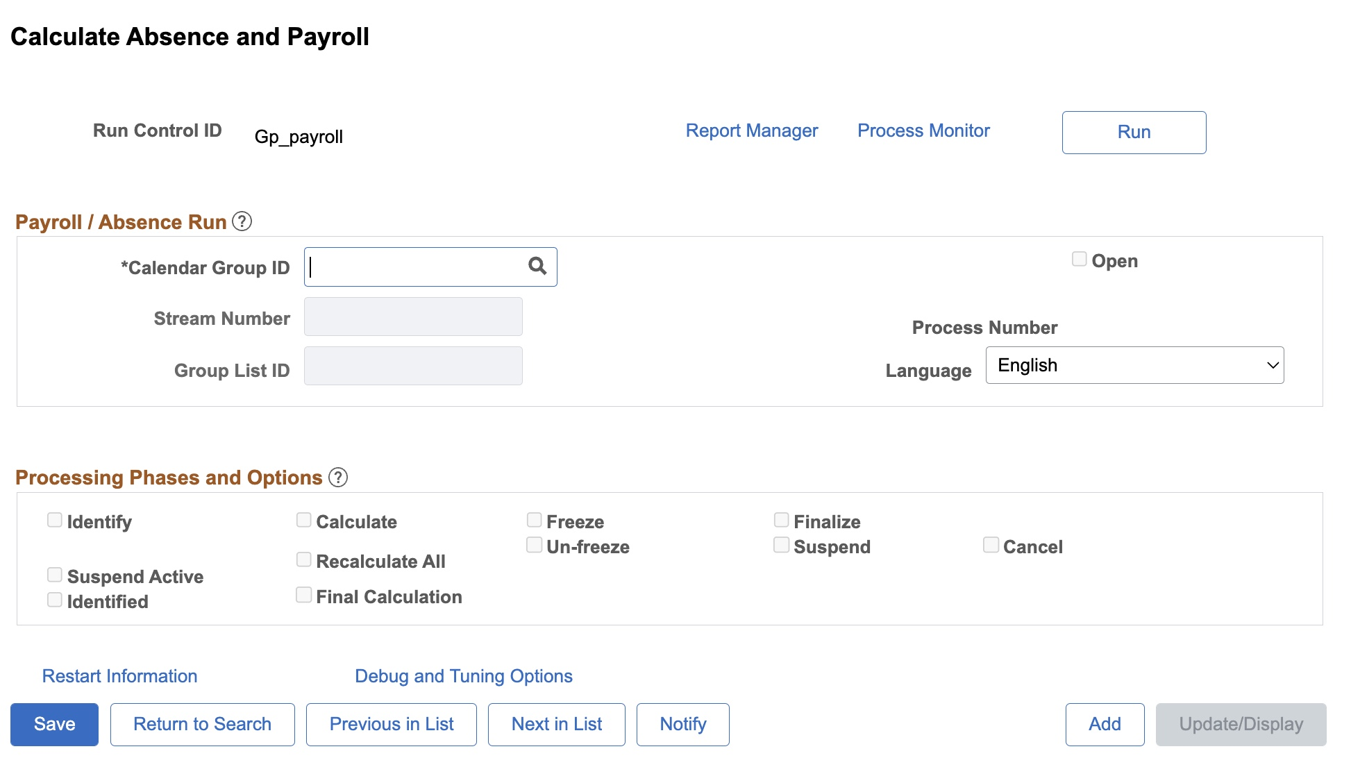

Use the Calculate Absence and Payroll page (GP_RUNCTL) to enter processing instructions for a payroll process, an absence take process, or an absence entitlement process.
This page is used to run both on-cycle and off-cycle payrolls.
Navigation:
Global Payroll & Absence Mgmt > Absence and Payroll Processing > Calculate Absence and Payroll > Calculate Absence and Payroll
This example illustrates the fields and controls on the Calculate Absence and Payroll page.

Calendar Group ID
Select the ID for the set of calendars to process. (The prompt table excludes calendar group IDs that have been finalized.)
Open
This is an attribute of the calendar group. The field is stored on the calendar group table. When the calendar group is initially identified, it is considered open, and the check box is selected. Once it is finalized, it will no longer be open, and the check box will be deselected.
Stream Number
If you selected the stream processing option on the Calendar Group ID page, the Stream Number field is available. The following conditions apply:
  • If you select Identify (as the processing phase), you must enter the stream number to process.
  • If you select Calculate, Un-freeze, or Freeze, enter the stream number here or complete the Group List ID field (if you have run the Identify phase for all streams).
Group List ID
To calculate, freeze, or unfreeze only payees in a particular group list, enter the group list ID. You can process only group lists that you created with your user ID.
Language
Select the language the system uses to display the Log File (which helps the system administrator determine whether a run completes successfully). The default is the Preference Language that is defined for the user.
See Creating Process Streams.
Processing Phases and Options
Select the processing phase to run. You can run some phases together, such as Identify and Calculate. Sometimes selecting one option makes other options unavailable.

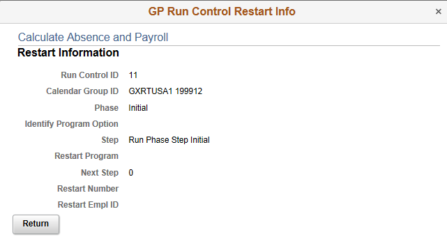

Use the Restart Information page (GP_RUNCTL_SEC) to view information about an aborted run, including where the system resumes processing after you fix the problem and resubmit the process.
Navigation:
Click the Restart Information link on the Calculate Absence and Payroll page.
This example illustrates the fields and controls on the Restart Information page.
Field or Control
Description
Phase, Identify Program Option, and Step
These fields identify where processing stopped, if the program made a commit during processing. Run Phase displays Initial, Iterative, Cancel, Identify, Calculate, Finalize, Complete.
Restart Program, Next Step, and Restart Number
These fields contain information only if the process was aborted during the Identify phase.
Restart EmplID
If the failure occurred during the Calculate phase, this field displays the employee ID number of the first payee that is to be calculated when you restart the process.
Note: When you restart the Calculate phase for a group list, the system uses the definition of the group list as of the restart time.

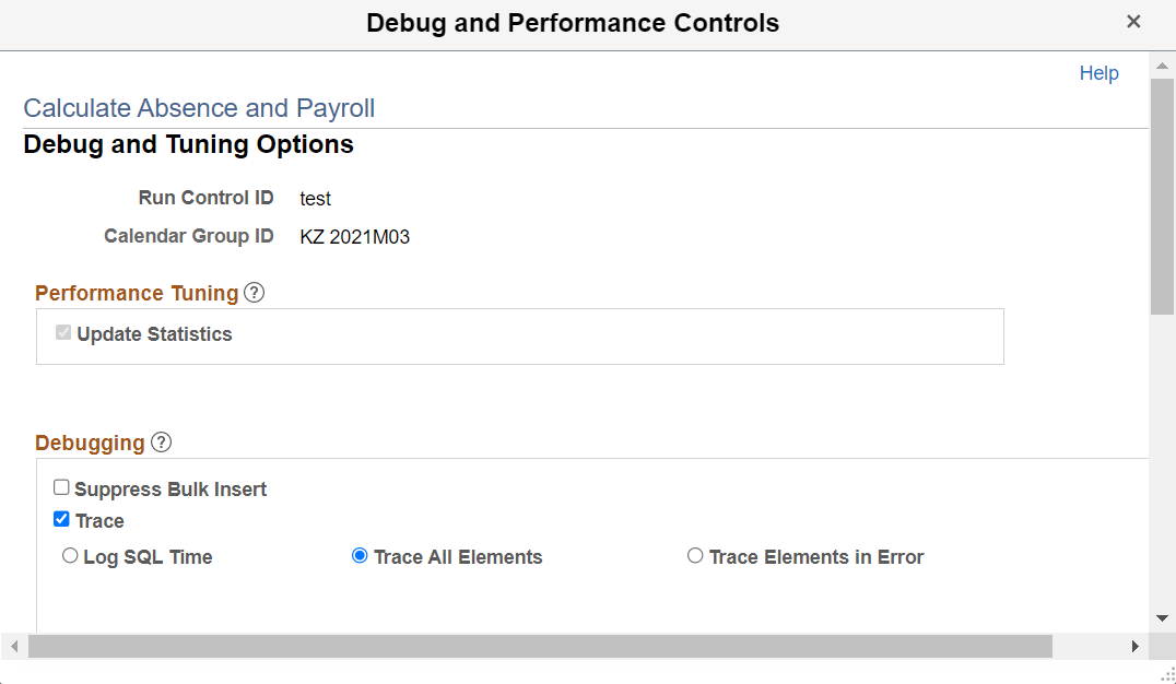

Several trace options are available during the Identify and Calculate phase. These options enable you to request an element resolution chain—a file with detailed results of the Identify and Calculate phase—for payees that will be identified and calculated during the next run.
Note: If you are calculating a large number of payees, selecting Log SQL Time, Trace Elements in Error, or Trace All Elements can degrade system performance. We recommend that you use these options for troubleshooting only. (These options require the same level of system resources.)
Field or Control
Description
Trace
Select if you want to produce an element resolution chain or log SQL time.
Log SQL Time
Select to have the Log File report each time the Payee Data Manager program opens cursors (SELECT statements that return more than one row) for the Job table, Job Dates table, Person Organization table, and the Person Organization Instance table during batch processing. This information can be useful for performance tuning.
Select to produce an element resolution chain that includes only those payees in error.
Trace All Elements
Select to produce an element resolution chain that shows how all elements were resolved for the calculated payees. You can determine the intermediate value of every element and the order in which the elements were resolved. When you select the check box Trace, this option is selected by default.

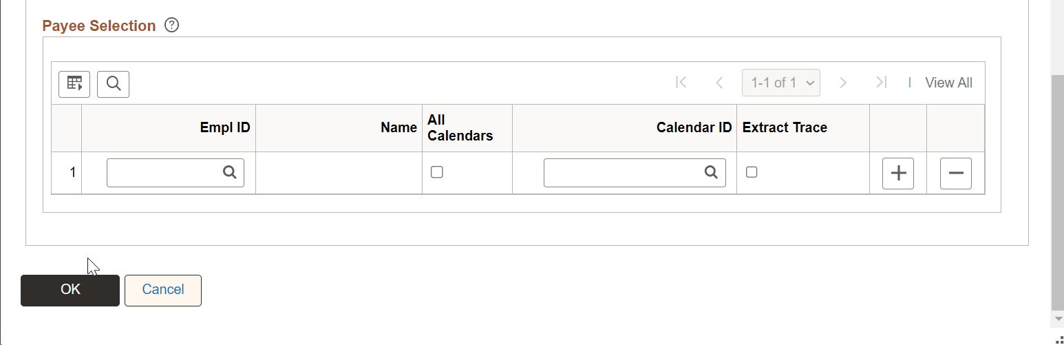

Payee Selection
Use the Payee Selection block to produce an audit trail 'Resolution Chain' from the element resolution for the specified payees.
This group box appears if:
  • Enable Advanced Trace Options is selected on the Configuration Settings page.
  • Trace Elements in Error or Trace all Elements are selected.
  • Identification phase has been run for the selected Calendar Group ID.
To produce the audit trail even when payroll fails, it will be required that you specify a payee selection.
Field or Control
Description
Empl ID
Select the employee for whom the resolution chain should be created.
If no value is selected in this field, then the resolution chain will be generated for all the employees being calculated.
All Calendars
Select this option if you want to generate the resolution chain for all the calendars being executed for the selected employee.
Calendar ID
Select the calendar for which the resolution chain should be created.
Extract Trace
When this checkbox is selected, the trace content (GP_AUDIT_TBL) along with the setup of the elements executed during the calculation will be generated in a zip file. This zip file will be available from the View Log/Trace page for GP_PAYAFTER process. Elements included in the Elements Masking Setup, will be masked during the extraction process.

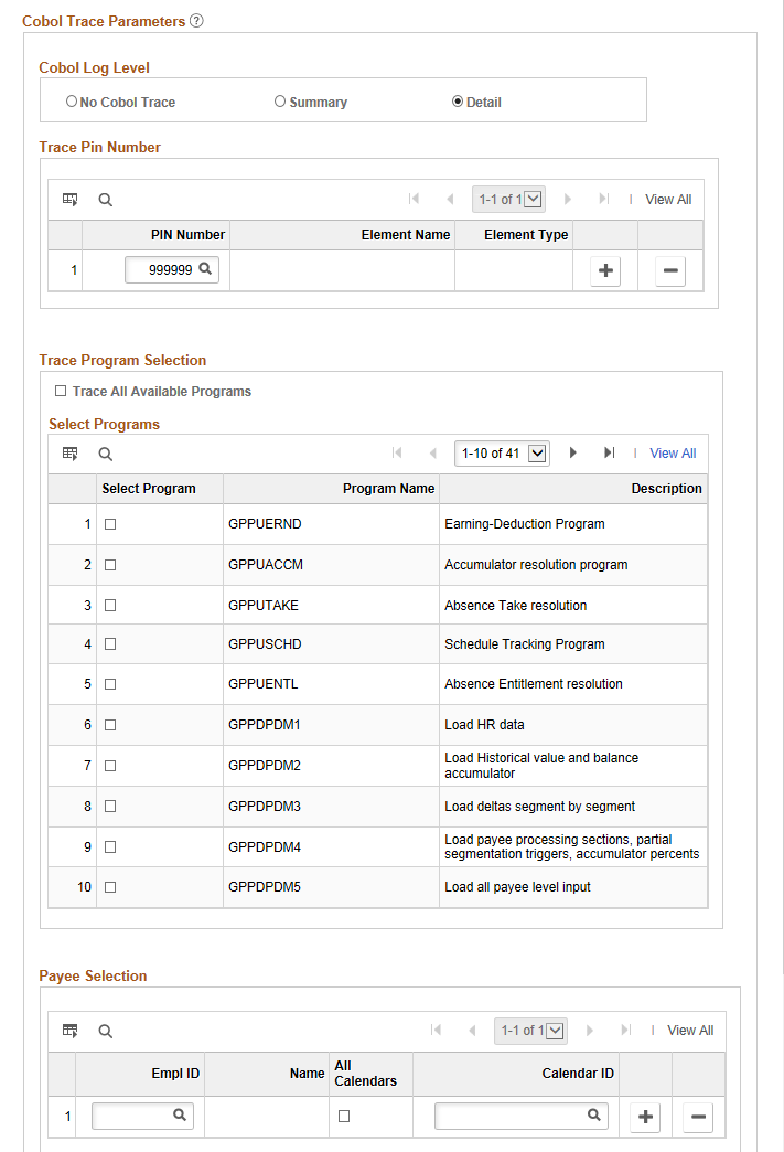

Cobol Log Level
  1. Enable Cobol Tracing is selected on the Configuration Settings Page.
  2. The Identify, Calculate or Recalculate All processing options are selected for the calendar group ID.
Field or Control
Description
No Cobol Trace
Select to disable the Cobol trace for the calendar group. This option is selected by default.
Summary
Select to generate a log of all payees processed in the pay run. The log includes calendar, group list, and stream number details. Use this option to isolate a payee causing a payroll abend. This field is not displayed if only Identify phase is selected.
Note: Summary trace is applicable only for the Calculate phase. If the Identify and Calculate phases are selected, the Summary field is available. However, if the radio button corresponding to the Summary field is selected, only the summary for the Calculate phase is generated, because summary is not applicable to the Identify phase.

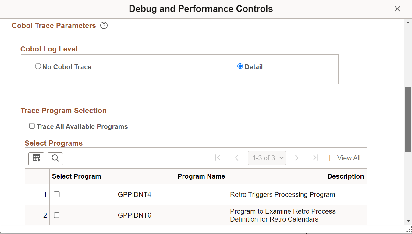

Detail
Select to generate a comprehensive trace of selected programs for specific payees identified in the summary run. When you select this option, the Trace Pin Number, Trace Program Selection, and Payee Selection group boxes become available.

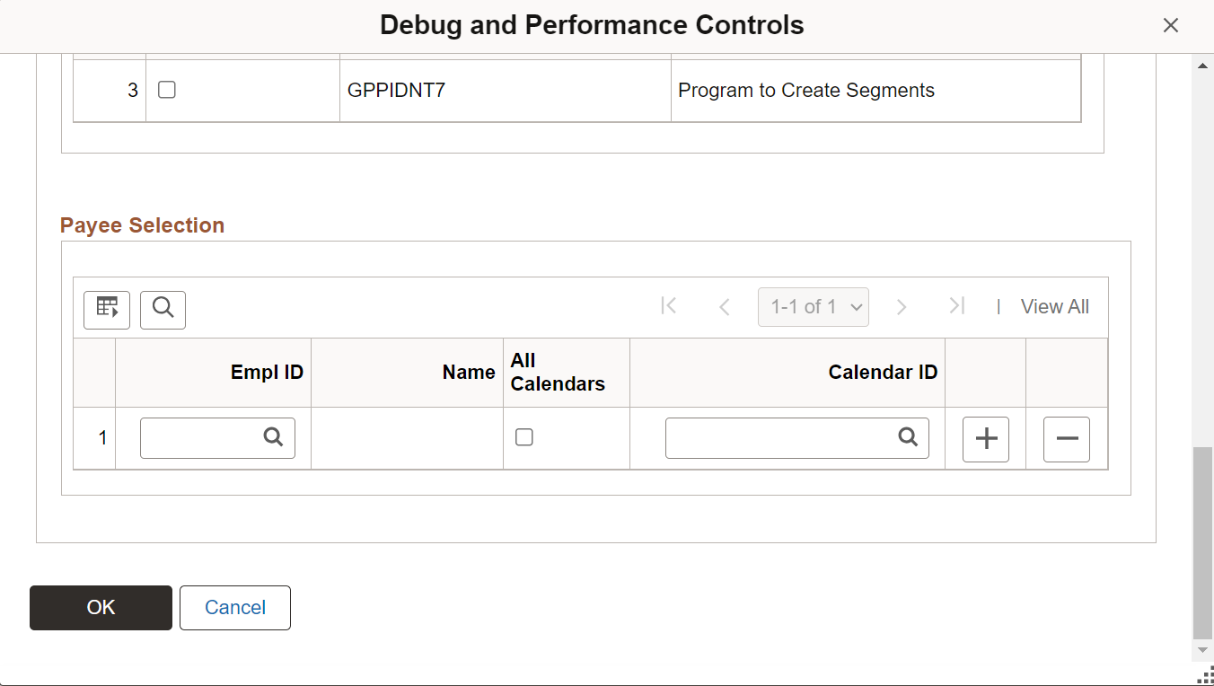

This example illustrates the additional trace parameters that are available when you select the Detail Cobol log level for Calculate phase.
Example of the Trace Pin Number, Trace Program Selection, and Payee Selection group boxes
This example illustrates the additional trace parameters that are available when you select the Detail Cobol log level for Identify phase.
Debug and Tuning2
Debug and Tuning3
Trace Pin Number
Enter the specific PINs you want to trace.
Note: If Calculate is run individually or in conjunction with Identify, the Trace PIN Number grid will appear. If Identify is run alone, it will not appear.
Note: It is recommend that you limit your trace to 10 PINs or less. Otherwise, the trace file could become too large to analyze effectively.
Select the specific programs that you want to trace.
Field or Control
Description
Trace All Available Programs
Select to trace all of the programs corresponding to Identify or Calculate phase.
Select Programs
If both the Identify and Calculate phases are checked, this grid lists all the programs corresponding to both phases. If only the Calculate phase is selected, the programs corresponding to only the Calculate phase are listed. If only the Identify phase is selected, the programs corresponding to only the Identify phase are listed.
Note: You cannot select PINs and Programs for tracing at the same time. Choose either PINs or Programs for tracing.
Payee Selection
Enter the specific payees that you want to trace.
When either Identify or both Identify and Calculate phases are selected, the Employee ID field lists all employees from the Job who belong to all the Paygroups that are part of the calendar group ID chosen in the Run Control page.
When Calculate phase is only selected, the Employee ID field lists all employees who are already identified.
If the Identify checkbox is checked, the Calendar ID prompt displays all calendars that are part of the specified Calendar Group ID. When the Identify and Calculate checkbox is checked, the calendar ID prompt displays all calendars that belong to the calendar group ID. When only the Calculate checkbox is checked, it indicates that the calendar group has already been identified. In this case, only the relevant calendar IDs that have been identified for that payee will be displayed.
Note: It is recommend that you limit your trace to five payees or less. Otherwise, the trace file could become too large to analyze effectively.

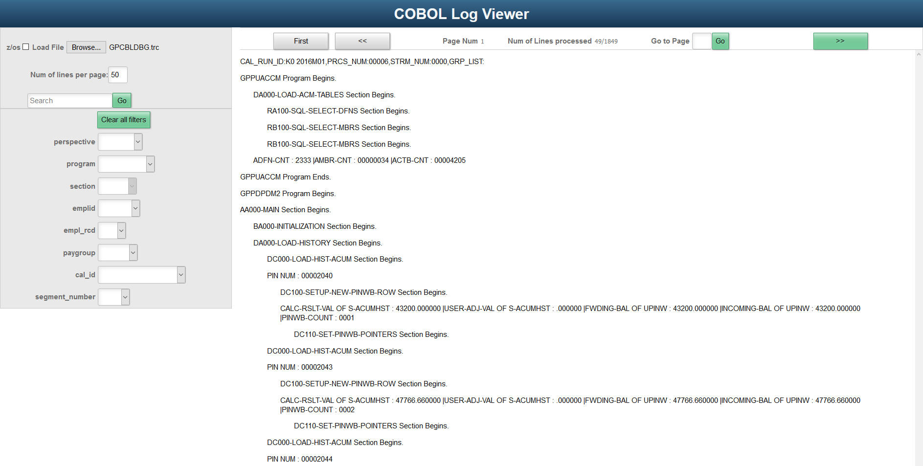

Analyzing the Trace File
When COBOL trace is enabled, the payroll process generates GPCBLDBG.trc trace log file. The best way to analyze the file is with the COBOL Log Viewer, which enables you to search and filter the trace log.
This is an example of the COBOL Log Viewer.
Example of the COBOL Log Viewer
You can download the COBOL Log Viewer (TracingTool.html) from My Oracle Support.
