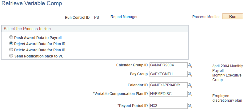

Use the Retrieve Variable Comp (retrieve variable compensation) page (GP_VC_AWARDS) to retrieve and validate variable compensation awards, reject or delete awards, and notify Variable Compensation at the end of a pay run.
Navigation:
This example illustrates the fields and controls on the Retrieve Variable Comp page.

Select the Process to Run
Field or Control |
Description |
Push Award Data to Payroll |
Select to pull information from Variable Compensation into Global Payroll. |
Reject Award Data for Plan ID |
Select to reject award data for a selected plan ID and payout period that has not been retrieved by Global Payroll. Warning! Select this option only at the request of the Variable Compensation administrator. |
Delete Award Data for Plan ID |
Select to delete award data for a selected plan ID and payout period that has been retrieved by Global Payroll but not calculated by the payroll process. |
Send Notification back to VC (send notification back to variable compensation) |
After a pay run is finalized, select this option to notify Variable Compensation of the results. |

Rejecting Awards
If the Variable Compensation administrator submits the wrong set of award records, you can reject all records for a selected plan ID and payout period if Global Payroll has not yet retrieved the records. This feature prevents further processing of the awards and should be used only at the request of the Variable Compensation administrator. When you reject awards, Global Payroll sends a message to Variable Compensation with this code:
Code 07: Reject All - Requested by User/Reject All.
To reject award records:
Select Reject Award Data for Plan ID.
Enter the variable compensation plan ID and the payout period ID.
Click the Run button.
Deleting Awards
You can delete award records that have been loaded into Global Payroll if they have not yet gone through the Calculate phase of the payroll process. When you delete records, Global Payroll sends a message to Variable Compensation with this code:
Code 12: Deleted from GP PI/Deleted
To delete award records:
Select Delete Award Data for Plan ID.
Enter the variable compensation plan ID and payout period ID.
